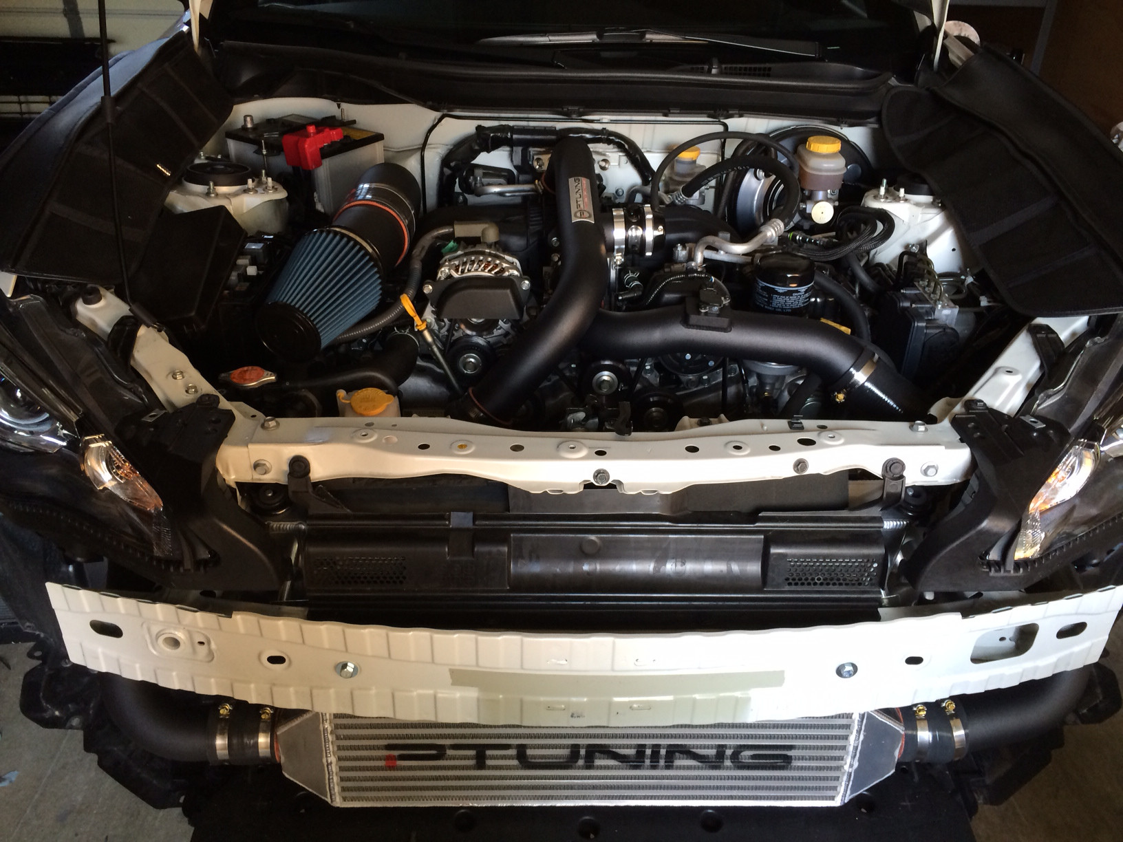

Wow a proper rotational firing order, rare on kits for these cars. I thought mine was the only one that had that . Good job!

Originally Posted by mkivsoopra View Post
Coming down the final stretch. I have a question though... what radiator are you guys using? I have the Robispec and it seems to be a little bit too big.
@ptuning
We're running the koyo racing radiator on our FRS. We've install the same radiator to @kanundrum frs as well as selling the same radiator to a few of our customers out of state that have also purchased our turbo system. We anticipated that most people running our turbo system will upgrade to an aftermarket radiator so we made sure our FMIC clears the thicker radiator core like the Koyo.
If you notice that with our FMIC, we used the largest Bell Intercooler core possible but still allow ample clearance above the FMIC and below the bumper beam to allow some fresh air to flow directly to the radiator and not just heated air from the backside of the FMIC.
MrC

damn that's sexy in black.
That is the setup I was considering. Is it actually interfering with the piping, or intercooler?
andrew20195 is offline   Reply With Quote
Old 02-14-2014, 05:10 PM   #55
mkivsoopra
Posts: 805
Thanks: 939
Thanked 950 Times in 412 Posts
Mentioned: 161 Post(s)
The front bottom pushes forward, making the AC condenser contact the intercooler, and the rear top is pushed farther into the engine bay, so you can't use the intake shroud pieces that come with the turbo kit. You can make it work... I'd just rather not.
