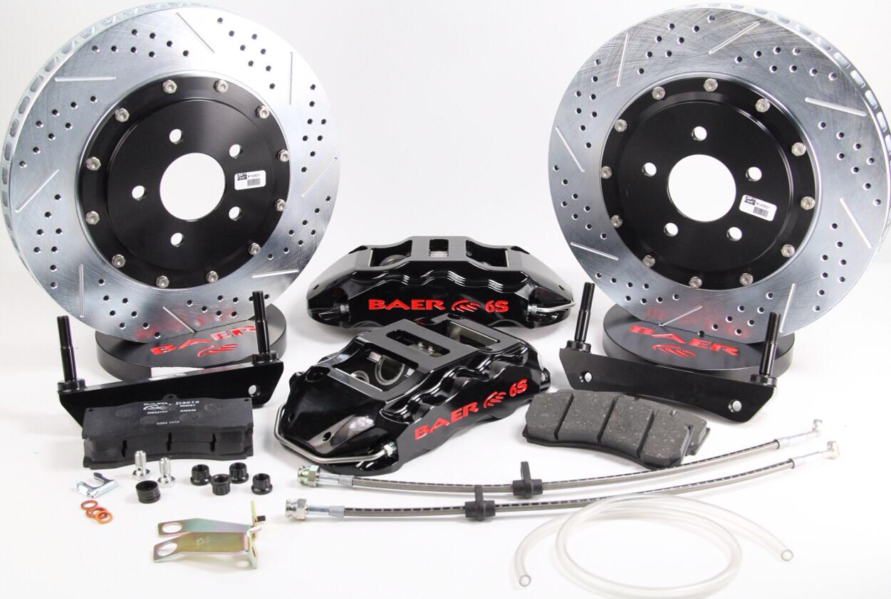

I have the Baer big brake kit on order. 6 piston 14” front with two piece race style rotors, 4 piston 13” rear with two piece race style rotors.
This is an amazing FRS specific kit, should look great with the Vossens I have on already.
I just have no idea how it will all fit together lol.
What makes it amazing? Nothing against the quality of the kit but a kit that large is, IMO, too much brake even on a boosted dedicated track FRS/BRZ. Nothing against people running it but you could get by with a whole lot less and get more performance out of it (lighter weight, etc).

I have always been a fan of Baer, I know it's overkill, but why not? Not sure how much preformance you can get out of brake kits, other than stopping, but maybe I am missing something.

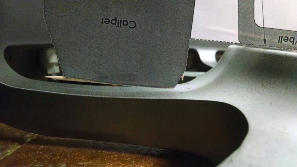

I printed out an Essex Sprint template to test against my Kosei K4R 17x7s, and they are close:
I know it's hard to get a good sense of scale from my crappy picture, but there is about 2 mm of space between the spoke and my toothpick reenforced paper (TPRP) template. How are y'all making your templates sturdy?
