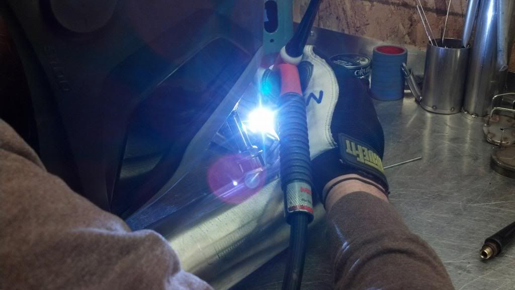

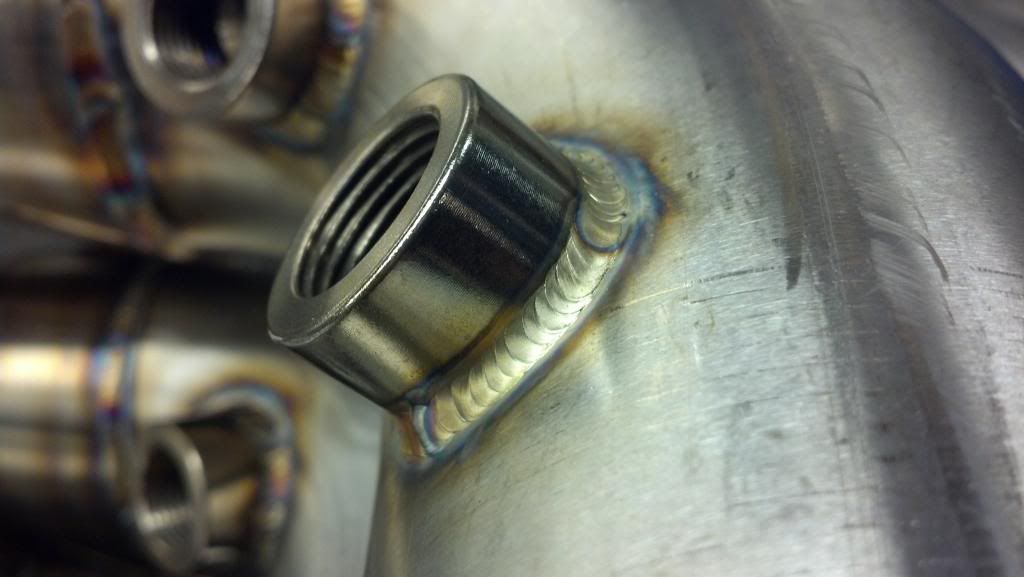

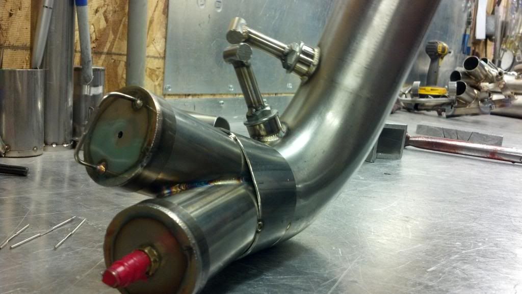

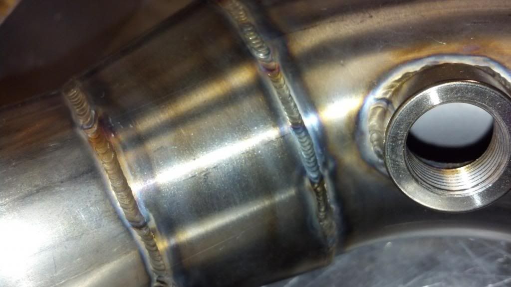

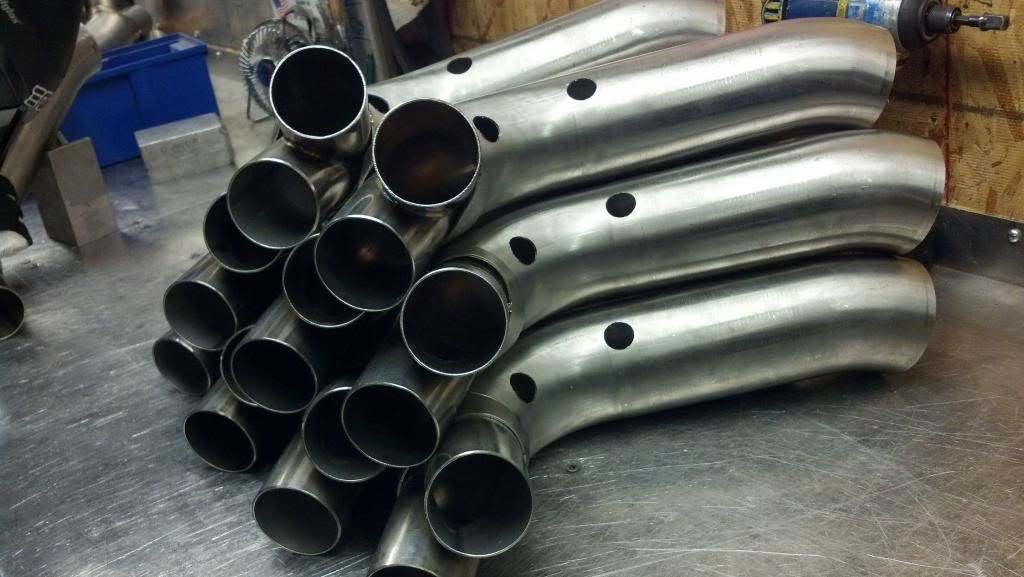

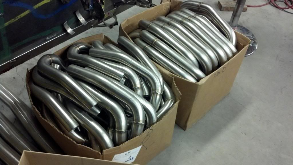

Here you guys go, some more fab pictures.
Hope everyone has a great weekend!

Whats going on in this picture? Leak testing?

Backpurging the pipe so the interior of the weld is shielded as well as the exterior.
