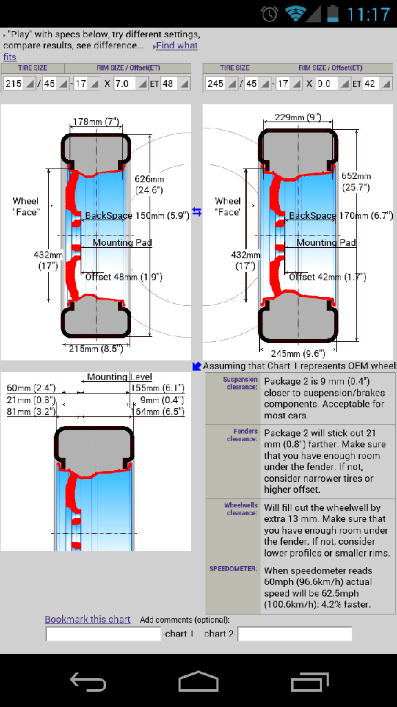

Originally Posted by Flat Black VW View Post
Ive got a set of these wheels waiting for better weather. What size tires are you running?
I got the titans in 17x9 all around and am planning on 245/45 front and 255/45 rear with hotchkis springs.
They're 245/40 all the way around. You might consider running a 40 aspect ratio instead as your 245/45 is going to have larger overall height than stock and will affect your speedometer accuracy and final drive ratio (acceleration). I would also recommend running a square setup so you can rotate your tires for wear. Post up some pics!
Yeah I was basing my tire sizes off memory, 40 aspect ratio is what ive got in my tirerack cart, waiting on tax return. I will definitely be posting some pictures as soon as I get them mounted. Got the titans in white and the car is SWP.
Glad to see the 245s fit up front pretty well.
