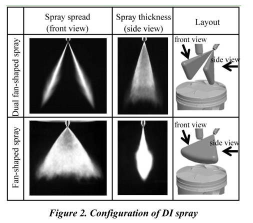

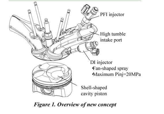

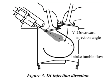

So Toyota is introducing a new generation D-4S system. I'm not sure exactly which engines it will end up on. The main differences are a high tumble port and a single fan-shaped spray designed to work with the tumble flow. Remember that the original D-4 direct injection was a high swirl combustion, and the D-4S on the FA20 is focused on high intake port flow. So this new system is following the industry trend of high tumble ports for faster combustion.
In the picture below you can see the difference between the D-4S dual fan spray which is presumably in the current GT86, and the new fan spray configuration.

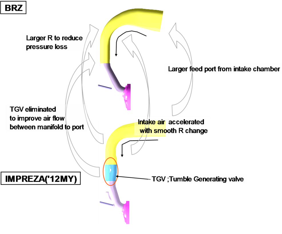

So I tracked down the technical paper that is specific to this FA20 engine, and it clears up a few things (see end of post where I have attached it). The spray pattern appears to be a single fan spray, angled differently than the old twin-spray pattern for V6 applications:

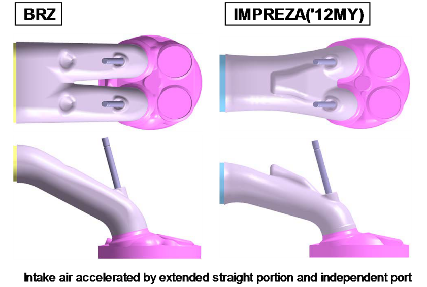

That makes sense considering it is a boxer engine. Here's an image showing a comparison between the FA20 intake port and the FB20 (basic naturally aspirated Impreza engine with PFI)
As I've said in the past, the fan-type injector is currently on used on Toyota D-4S engines. How about a comparison for context. What would a different DI spray pattern look like? Let's briefly examine the Porsche 997 turbo:

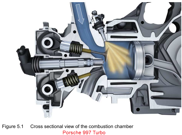

That's a multi-hole spray pattern with a high charge-motion port, designed for fast combustion and knock relief on a turbo engine. There are no port injectors. However, Porsche uses a high lift cam profile and multiple DI injection events for knock relief and more efficient combustion:

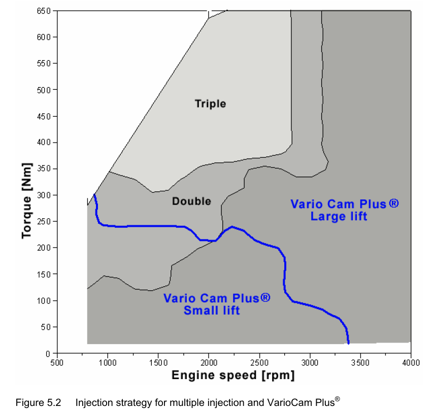

You can see the use of three injection events at low speed full load. This is unusual on solenoid DI injectors, as usually only piezoelectric A-cone injectors employ three injections. Compare that to our FA20 operation map, with fixed cam lift and as far as we know single DI injection events only:
So you can see a nice comparison there between combustion highly optimized for a high flowing, high revving n/a boxer application versus one highly optimized for a turbo. For reference, see attached paper on the FA20.
