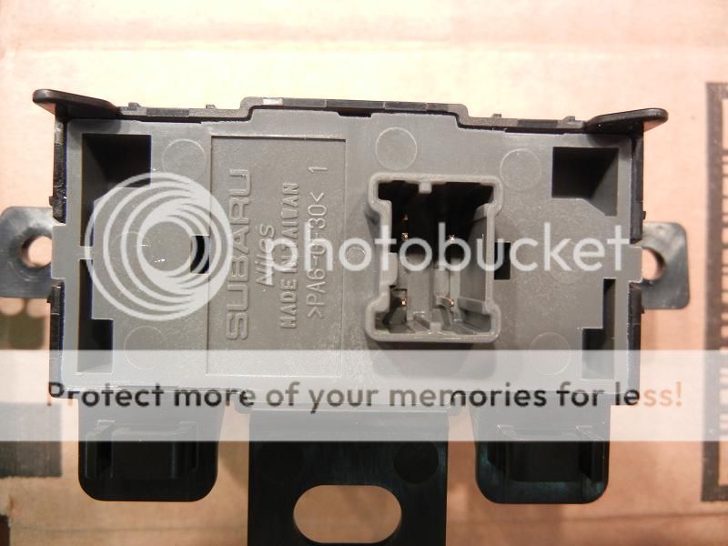

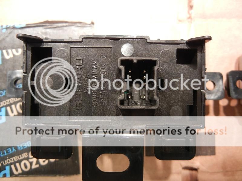

The buttons are decently firm, but they're only momentary buttons. To use them as an actual on/off button, you'll need to attach them to a latching relay. Basically you press the button and the relay leaves the lights on. Press the button again and the relay leaves the lights off.
These are the relays I usually use:
http://www.deiproducts.com/servlet/t...iswitch/Detail
Lots of options for what you want to hook to the switches at that point.
Below I've got pictures of the back of the stock 6MT switch (gray) and the Automatic switch (black). If you look at the pins on the upper right of the black switch, you'll see there are two extra pins. Those are the outputs from the two buttons. The bottom right pin is the input (I assume it's a 12v-, but I haven't gotten that far yet).
The extra pin on top is for the button on the top. The extra pin in the middle is for the button on the bottom.
