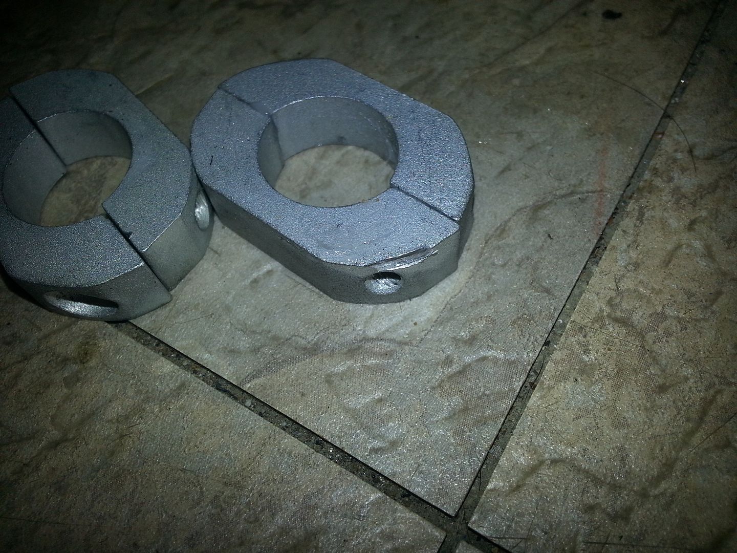

Found a couple of the issues tonight.
The colars are indeed grinding when the bar rotates:

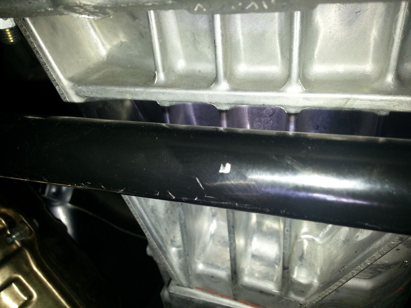

And right in the middle of the bar it was contacting a small imperfection on the aluminum steering rack so I grinded it down a touch:
I also found a spot where the bar might be contacting the frame above it but I'm not 100% on that yet.

Clunking it typically a loose endlink or the bar itself being loose on the... well what I'll call the "frame" of the car.

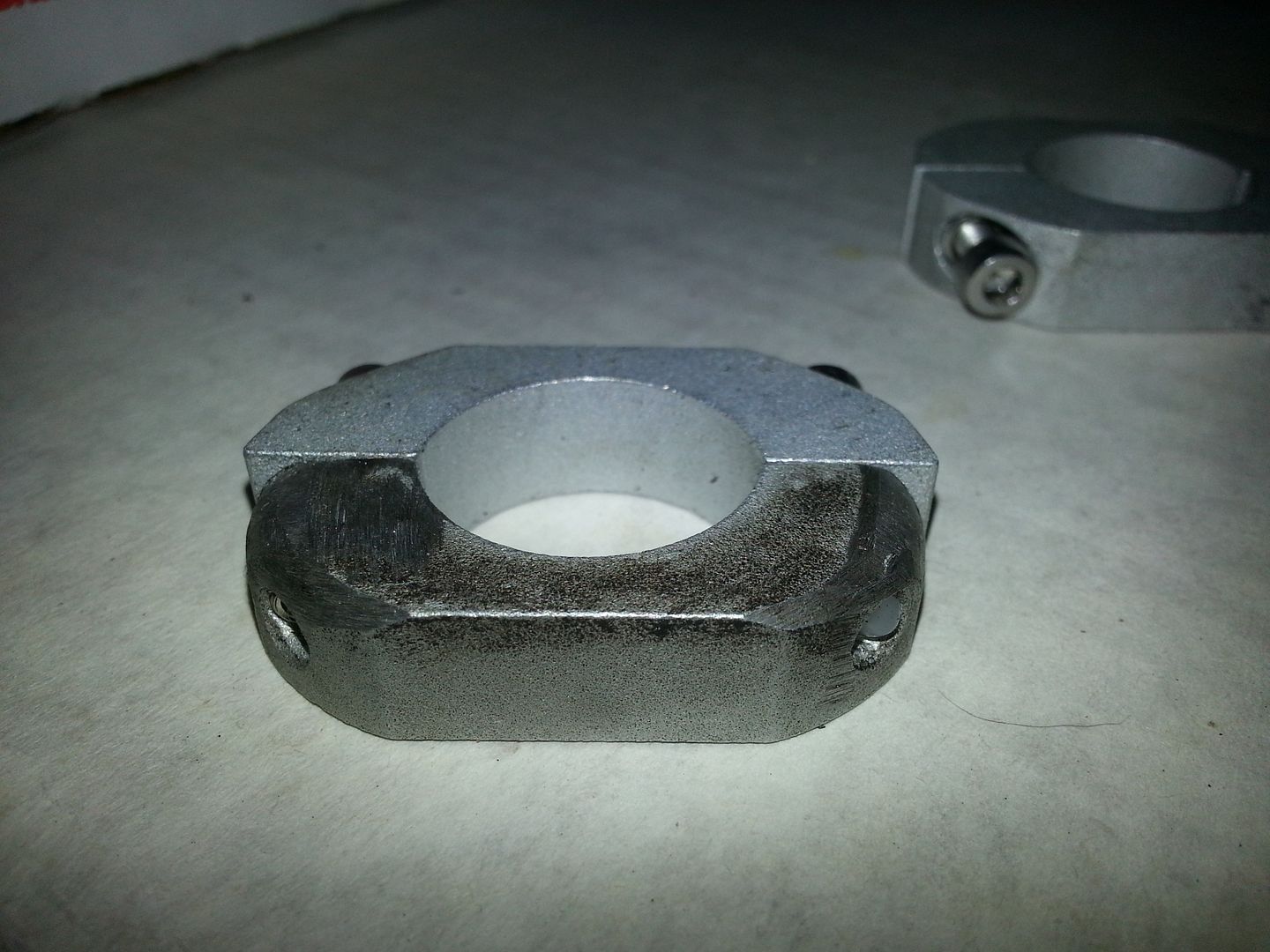

The collars are aluminum and you have to play around with the clocking of them a bit. The stock bracket that holds the bar bushing on the car isn't 100% symmetrical. The newer bars are wider from bend to bend. I wanted to not use collars (and you see why they can be a pain). But look at it, you might be able to run the collars on the outboard side and eliminate the issue. But honestly because the collars are aluminum, and you can easily see where they touched you have a pattern to use to knock the corner off the collar. As long as you don't get into the threads it's fine because there isn't any real load on the collars. Just there to keep it from walking around.
And another option is a spacer. A large flat washer with a 7/8" hole (to fit over the bar)... that then goes up against the bushing and the collar up against it, moving the collar away from the steel bracket.
I've been searching for collar clamps that work without any issue for anyone, all the time. But if you look at the them it's not like the things are huge to start with. They aren't wide, they aren't 3" across. The stock bar relies on the metal rings clamped on the bar to keep it from walking and that's just not feasible here.

I'm trying to grind down the aluminium colars but I've got to take a lot of material off to get them to clear the brackets.
Meanwhile I've been running without them and I see no evidence of walking so that's good.

This is how much I've ground down the colars so far and they still hit the brackets a little...

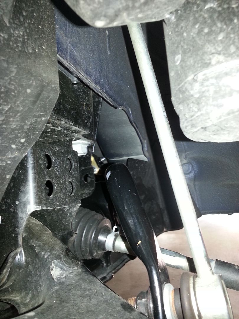

After a full season with the bar I can say I like the feel but the bar still walks. I have one of the first batches so they might have adjusted it a bit since. It was really bad with stock links but aftermarket adjustable links (I'm using whiteline) helped a bit. Under full load it contacts the A arm. I think if the corners of the bar where the link is connected were rounded off it would help. I'm going to try collars next season to see if it eliminates the walking. I also bought slicks for the first time so that will change the feel entirely.

With whiteline links mine touches nothing ever.
