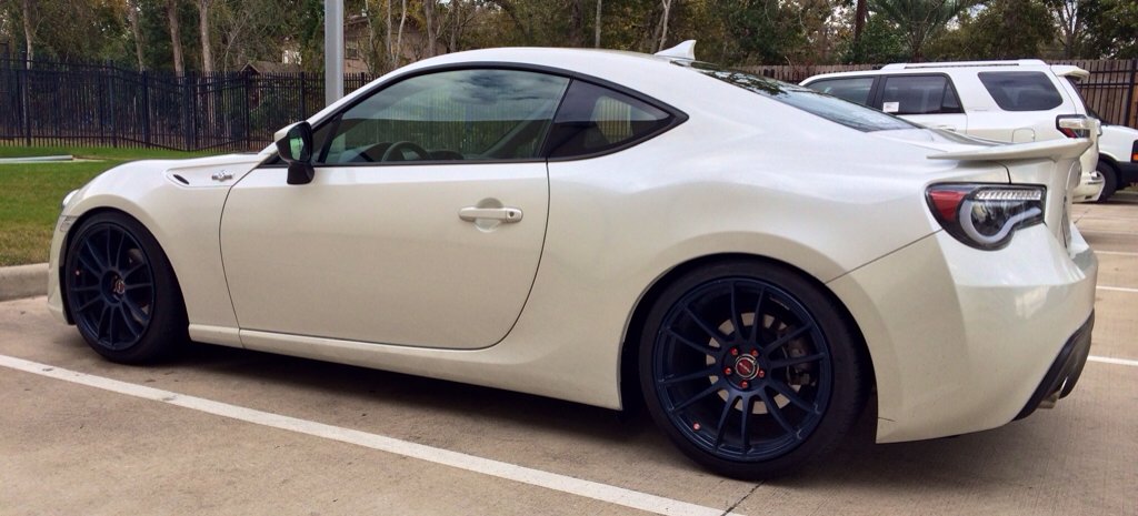

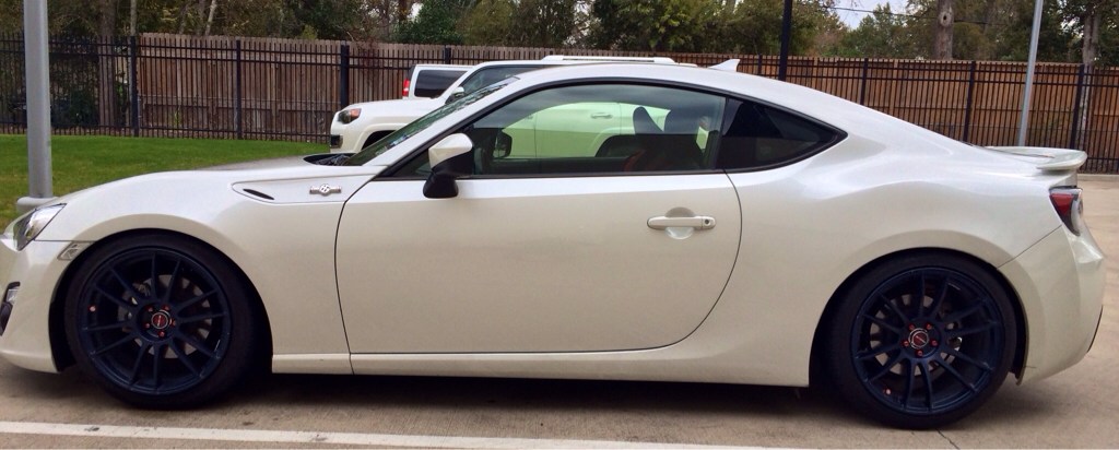

Size:  95.1 KBName:  ImageUploadedByTapatalk1387045342.601321.jpg
ST out of the box.
If my calculations are correct, when this baby hits 88 miles per hour... you're gonna see some serious shit.

Attachment 60049Attachment 60050
ST out of the box.
Thanks for providing the info I've been searching for for awhile! Looks like my Sportline drop so I'll keep the factory settings when I receive and install mine.
I guess the strut rod is allen keyed? Anyone know the size of the strut rod's keying (stock is 5mm and 6mm) and the strut top nut size? Curious if everything is "normal" and not unusually sized (like an oversized top nut or rod keyed beyond the range of my hex bit set) in which case I'd have to buy more hardware.
