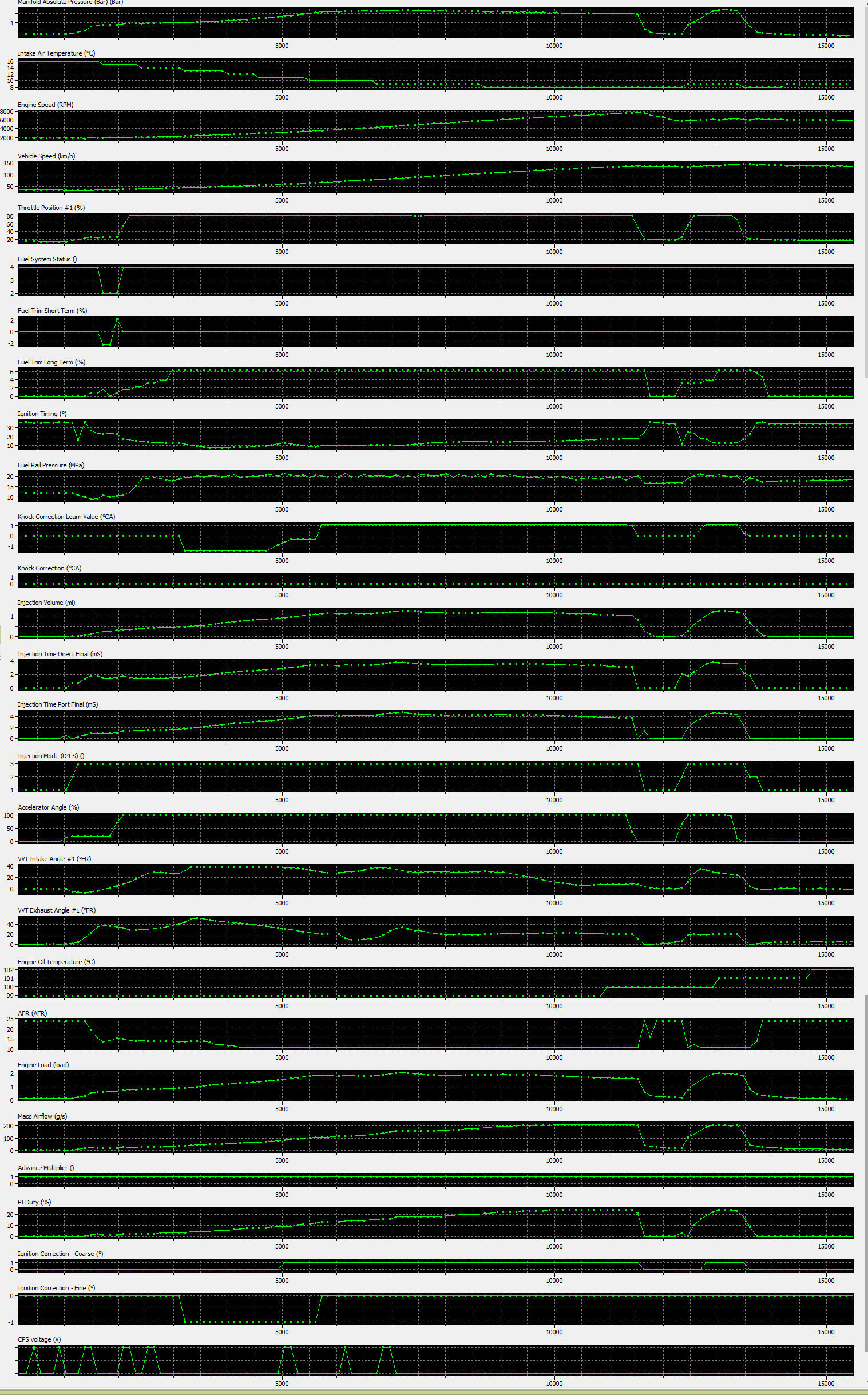

Old 02-04-2014, 11:21 PM   #63
gdrider77
gdrider77's Avatar
Drives: Subaru BRZ Limited
Location: Denver, CO
Posts: 623
Thanks: 243
Thanked 263 Times in 157 Posts
3rd gear pull.
This is log from a recent pull. Anyone car to look it over and give me any insight. Good/bad...
Thinking im good, but would like a bit of insight.
Is the knock correction learn value a concern?
Map readings, how can i tell if my 3-bar map sensor is setup and reading correctly?
Thanks all
Here is the log file.....http://d.pr/f/bwUb
and an image for others to just look at...
gdrider77 is offline   Reply With Quote
