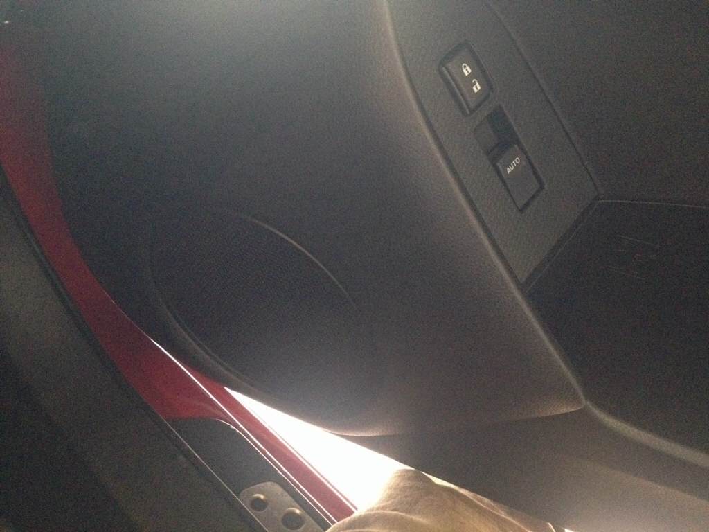

Do you have to take off the door panels to replace the door speakers? Or does this pop right off Name:  ImageUploadedByTapatalk1385243238.184624.jpg

You have to remove them.the grills are held in with 7 screws from behind.

Those dont pop off. You pop off the silver handle and take out the bolts and then the other rivets by the door handle and up in front of it. Then just pull

Start to pull from bottom edge first.w screws behind here.
These are easier then they look.pull the white and green cable pieces from their holders and release the balls from the handle and lock carriage.
