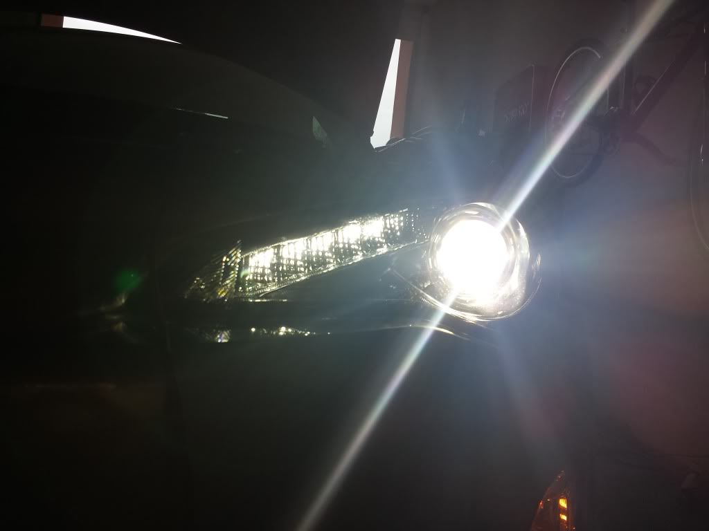

I found that the 400 ohm resistor was the perfect level of dimness for myself but feel free to experiment with lower ohm resistors to get the level of brightness you want.
Finally a shitty cellphone picture of the headlights with LED's lit up.
This is with 500 ohm of resistance.
These are with 400 ohm of resistance:

I just went outside and took additional pictures in the different cycles.

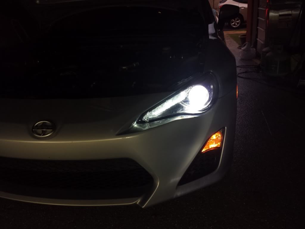

When I did mine I bought 560, 470, and 320 ohm resistors just so I could try a few to get the brightness right. Put the 560 in and I could barely see them, even with the lights in the garage off. Went straight to the 320, and that's still less bright than I'd like them to be. So mine are definitely less bright than the OP's and more in line with Luis's.
Also, the DRL on the passenger side, where I put the resistor, seems brighter than the one on the driver's side... I really don't know that much about electricity/physics, but this doesn't seem like it should be happening. I'm going to get a lower impedance resistor and add a diode. Hoping the lower impedance and higher voltage will make the difference either go away or less noticeable.

Here's a shot of my headlights with the 320 ohm resistor. It's hard to tell, but the passenger side DRL is a little brighter. And yes, it started snowing today. Come to find out my Blizzaks work pretty well in empty parking lots...sideways...
