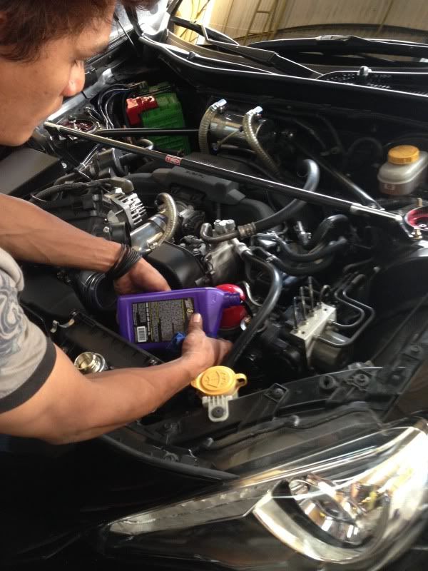

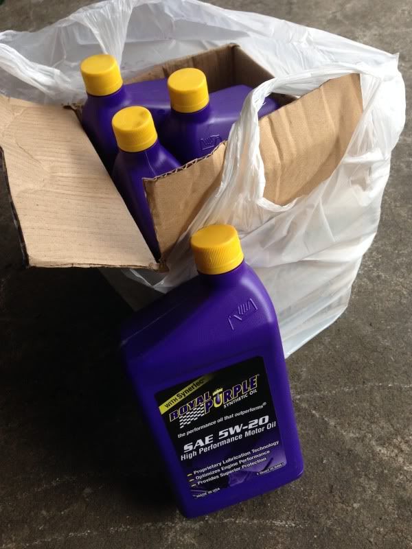

Oil Change to Royal Purple 5w-20:
I felt the engine revved easier and ran quieter with the 5w-20 than the HKS Super NA racing oil (5w-40). I did the oil change the day before the event, and I think that the Royal Purple oil performed admirably.

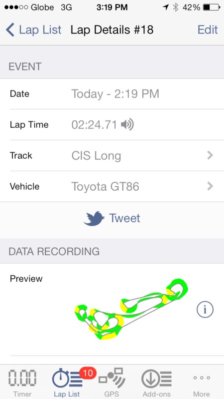

I beat my previous best lap again with a 2:24. I experimented with some new lines and tried using more of the track to carry more speed through the turns.
The Dixcel Brake pads still performed great, I did not notice any fade, although we were given only a total of 5 laps per session. With the long track, the brakes are given a workout, 180kph-50kph, 140kph-40kph in some parts. 5 laps would have given me some fade using the stock pads, but the ES pads did not. Overall I'm pretty happy with the ES Pads. Maybe next year I'll try out the Z pads.
My best time was good enough for 4th overall in class C, and a podium finish in the 86/BRZ class. Two podium finishes in 2 weeks is not bad! I'm joining another time attack event this weekend and give the car another workout!

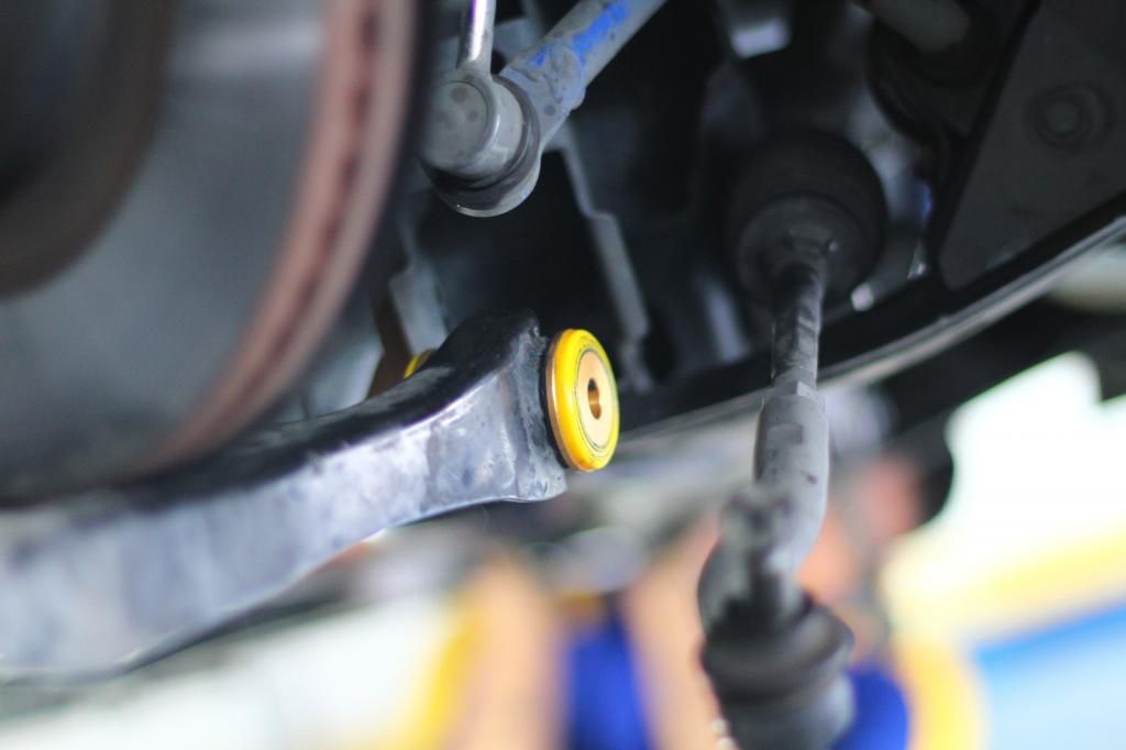

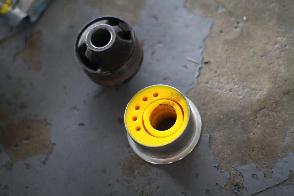

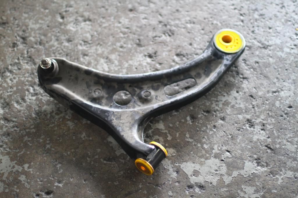

Whiteline & TIC Bushing, Megan Racing Rear Brace Install

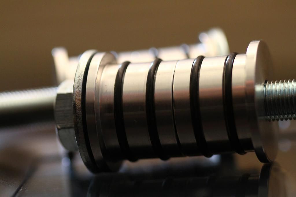

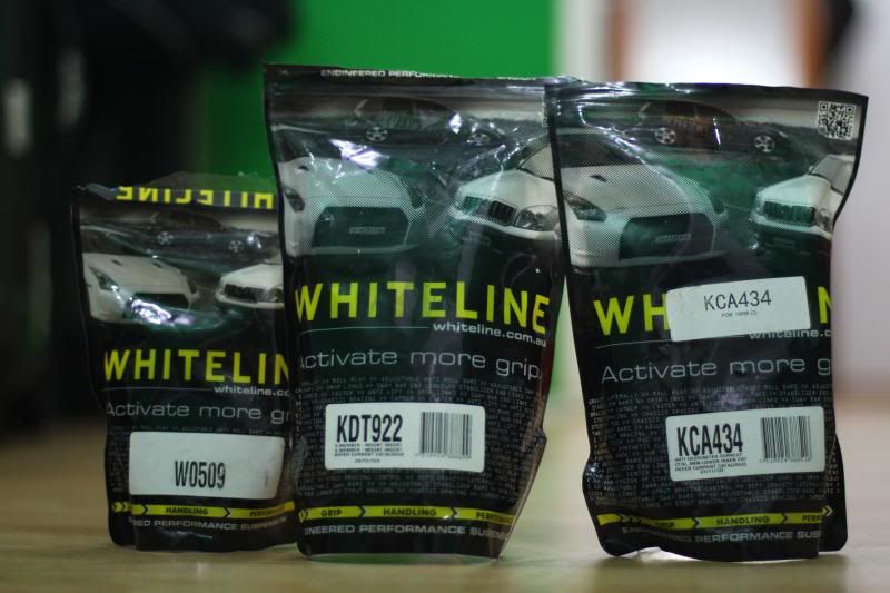

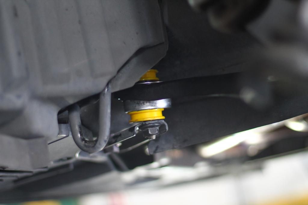

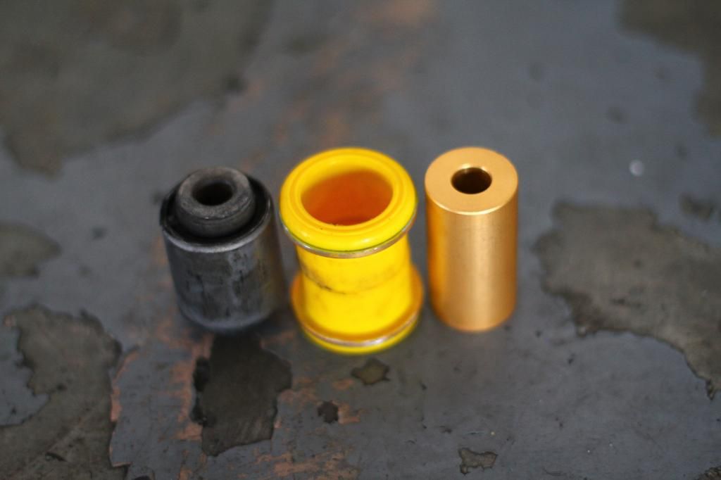

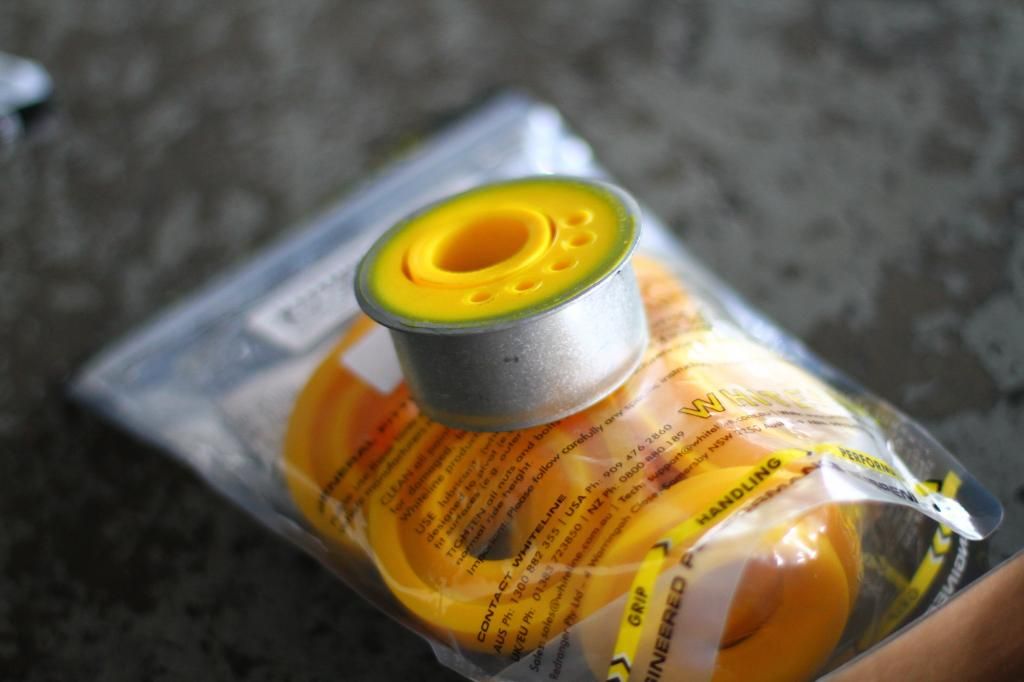

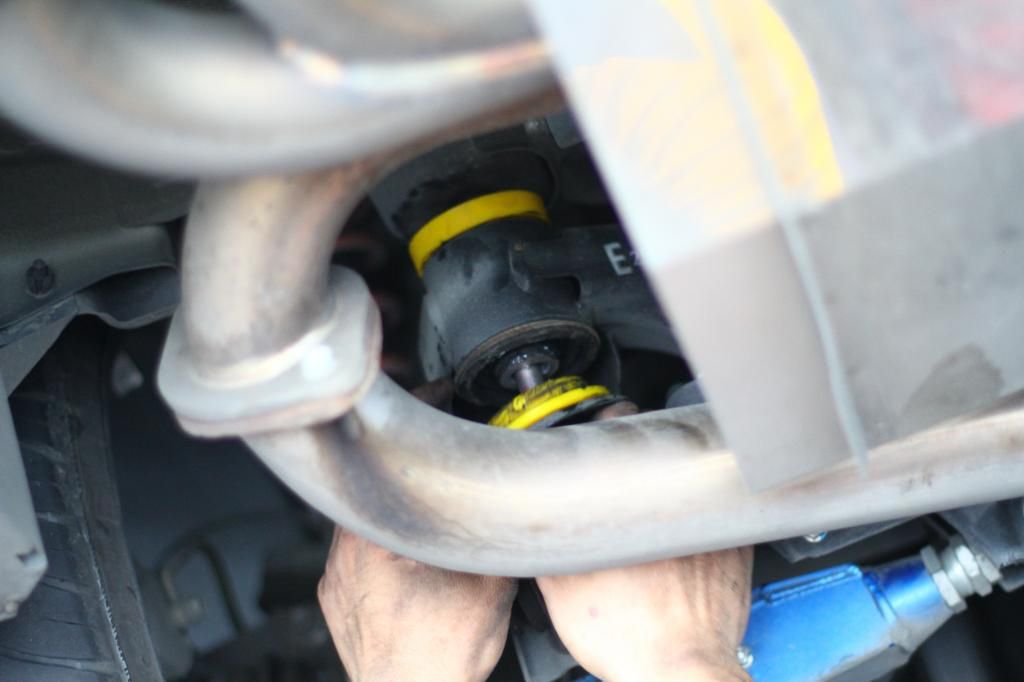

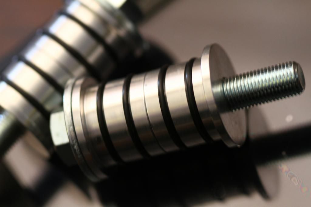

In my quest to get the ultimate grip and instantaneous response from my 86, I decided to try out some Whiteline suspension products. The item that intrigued me the most is the KCA434, which is the “Anti-Dive Kit”, which corrects the suspension angle (adding caster) to combat the nose dip when braking into corners. I also ordered the W0509, “Lower Inner Rear Bushing” since I would be taking out the lower control arm might as well change it too. The KDT922 is also a hot product for the rear subframe, so I thought that I couldn’t go wrong with this one too. There has been a lot of DIYs covering these products so I did not make the effort to take some step-by-step pics.

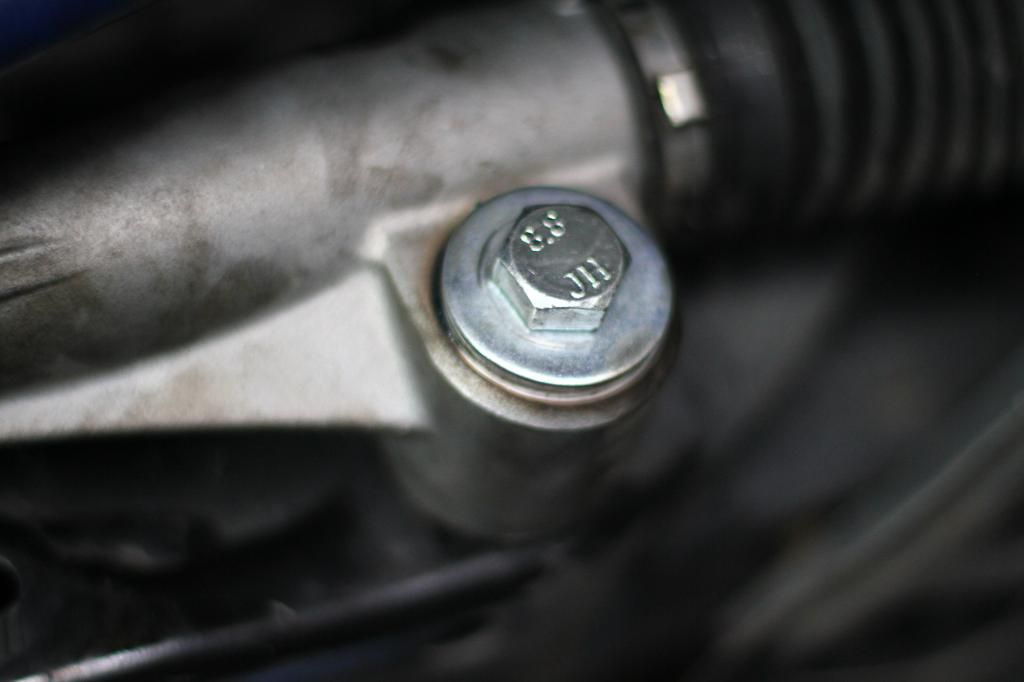

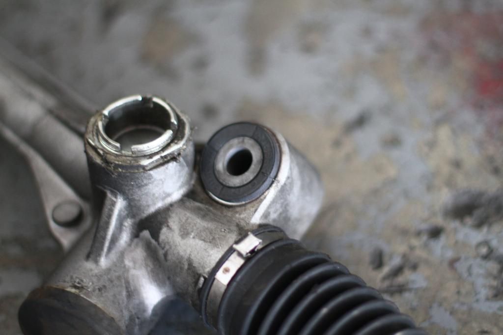

I also installed the Turn In Concepts solid steering rack bushings as some members have been raving about it. For $50, it was a cheap gamble for me.

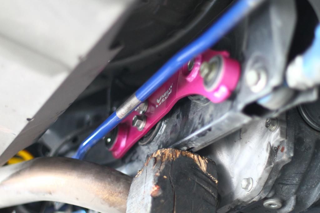

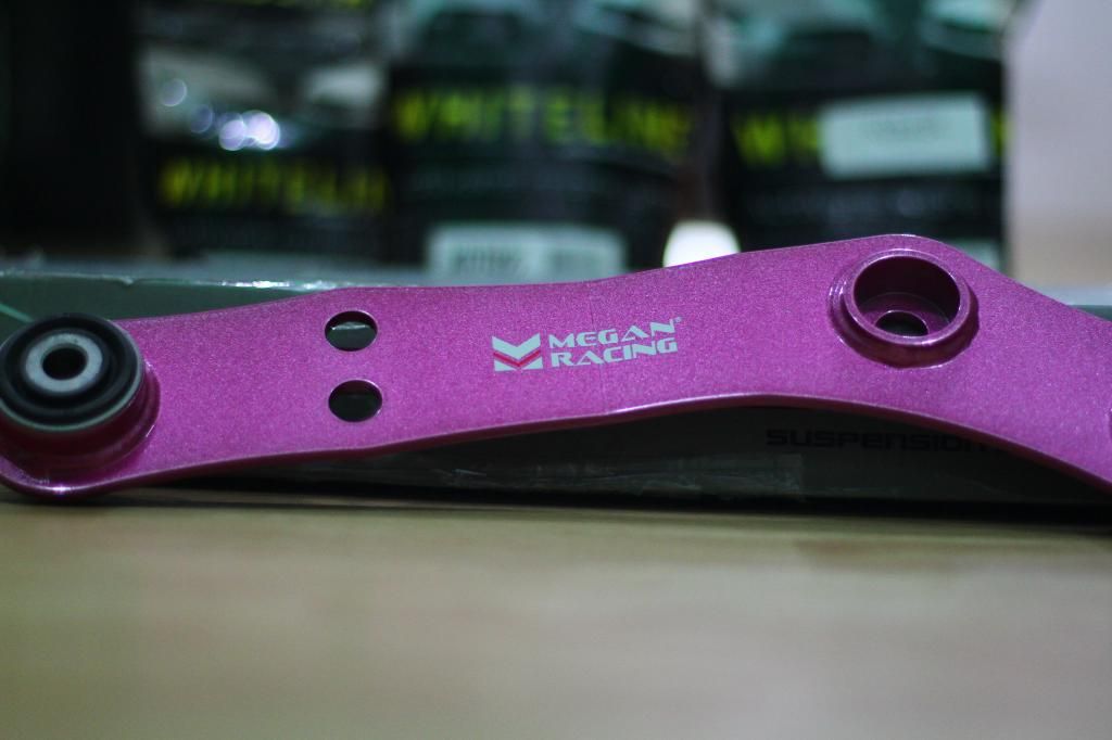

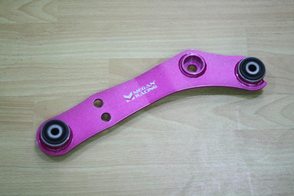

The only part I was skeptical about is the rear diff brace, as reviews were mixed about it. I figured if I was going to buy an expensive one and don’t like it, I’d be screwed. So I just ordered the Megan Racing one, thinking if I don’t like it, I’d just sell it for cheap. A brace is just a brace anyway.

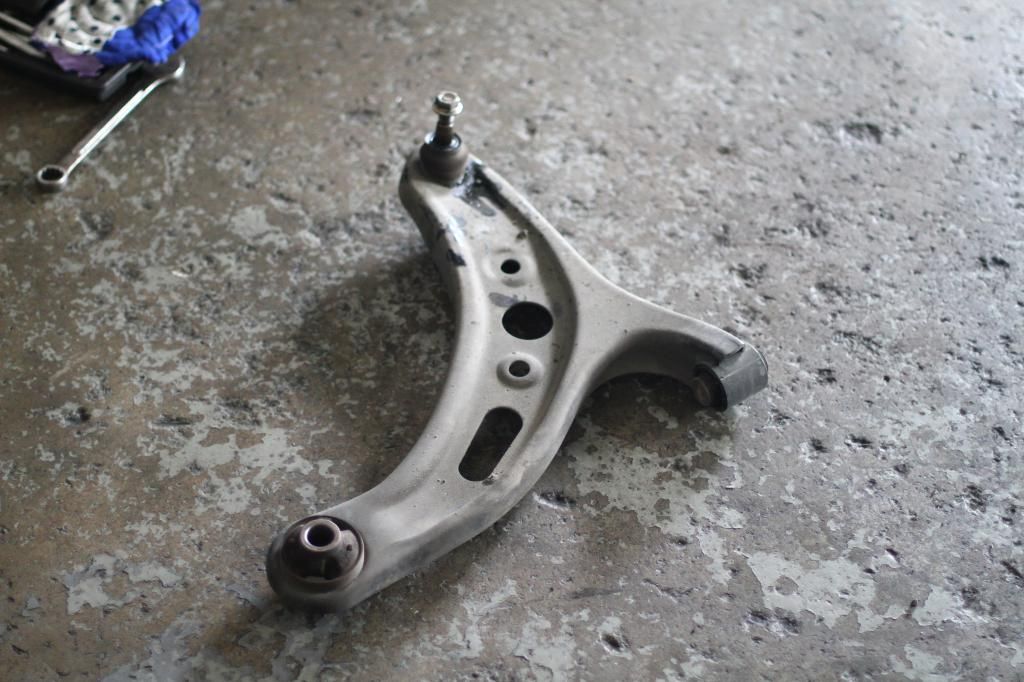

Installing the inserts took a long time because of the presswork. It also took some time to take the under panels off to get to the steering rack and front lower control arm. The rear parts were a bit easier to install, taking half the time because the press was not needed. All in all, it took 6 hours to install all of the parts.
Front lower control arm with stock bushings:
Whiteline Bushings installed on control arm:
Stock Steering rack bushing:
Installed TIC Steering rack bushing:
Taking the car for a test drive after installing all the parts was surprising. The first thing I noticed as I was backing up the car was how tight the steering feel was. It’s a different feeling from stock, as there is virtually no slop in the rack. The stock was already good, but it felt a little disconnected for me. After the solid bushings, I could feel the road more and the response was awesome. When you turn the wheel, the car just turns without delay.
I’m sure the front bushings also helped, but there’s no way to tell the diff unless I did the installs one by one.
Rear subframe inserts:
Megan Racing Brace:
I noticed the rear parts when I pressed the gas pedal, as acceleration was instantaneous. No delay from the soft diff bushings, no movement from the rear subframe, just a more efficient use of energy as I open the throttle. It kind of surprised me a bit, but I was smiling as I was test-driving, and driving this car made me smile even with the stock parts. I can’t wait to get back to the track and try this out.
I also noticed a bit more NVH, namely I could hear the driveshaft hum when I slow down or release the accelerator. The ride was noticeably stiffer, but not to the point of it being uncomfortable. I have an aluminum driveshaft on order, and can’t wait to pair these mods with that!

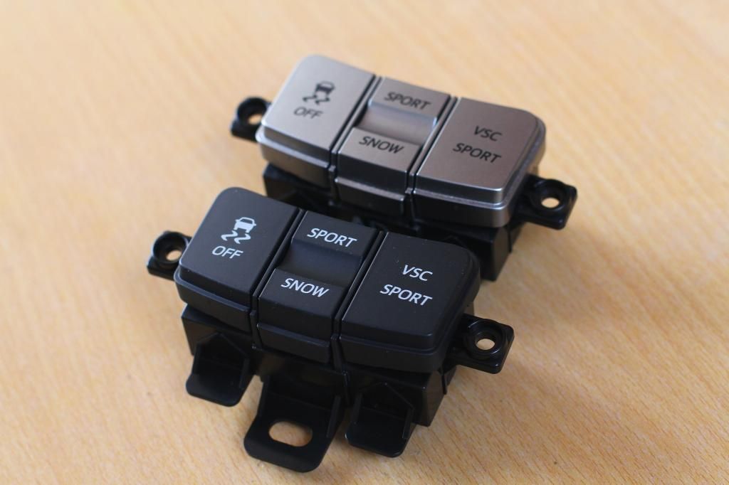

Installed Black TC Switches

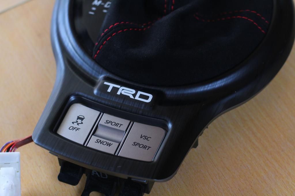

One more cosmetic upgrade! After installing my TRD shifter ring, my inner OCD could not take the weird look of the silver TC switches on the black ring.
After reading about the black switches on this forum, and finding out that the parts are readily available in Australia, I called my best friend who lives in Sydney. Ordering parts from him is relatively easy, as he used to work at a Toyota dealership. Thanks Carlo!
Black and silver:
Black on black:
Installed:
Definitely a cleaner look! OCD on hold for now.

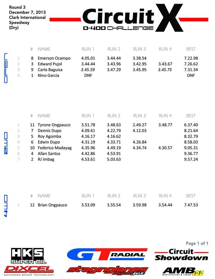

0-400 Round 3 Time Attack, Mod Impressions
The third leg of the 0-400 Time Attack/Circuit X series will serve as my shakedown run for all the mods to date from the last round. I have not been to the track since installing all the parts, so this will show how the car behaves with all the new mods. Mods are JC Racing aluminum radiator, Whiteline bushings, Turn-in Concepts Aluminum steering rack bushings, and Megan Racing Diff brace. This will also mark the last time the car will be NA, as I will install the Vortech Supercharger after this race.
Track layout used this round is a combination of both first and second round tracks with a cone on the hill which the driver would make a u-turn to get back to the start/finish line. Essentially the CIS track without the main straight.

Water and oil temps were down from the last trackday also. Water temp never rose beyond 100degC and oil temps never went past 120degC. The pesky AT safeguard never showed its head and left me alone the whole day.
All these things contributed to a hassle free day and another 1st place finish making it 3 in a row for me in the 2wd class.
