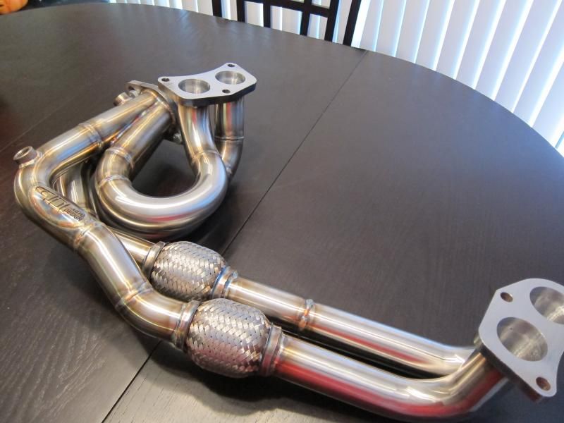

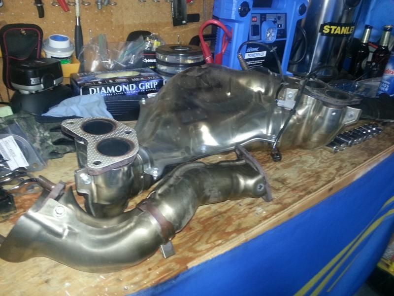

JDL header arriving tomorrow, so tonight I pulled the stock header and overpipe. I have a Perrin overpipe which will be going back in with the JDL header. So far, so good, although I can't imagine getting the overpipe out with the header still in the car!
Really easy if you just unbolt the engine mount by the overpipe, take a pillow or something and put it between the engine and a jack and jack the engine up slightly. Only need a couple inches and the overpipe will pull right out.

Yeah, they say you can get it out by just removing all the heat shields, but they are tough to get off as well. Once the header was off, I could get to the other heat shield bolt much easier.
Had the header stayed on, I think the engine jack method would be easier as you say.
-Max H.

Guess what I'm doing tonight... @JDLAutoDesign
-Max H.

Holy hell - this thing sounds absolutely amazing. Combined with an updated tune from Moto East, it feels really good as well.
I'll be doing some data logging to help perfect the tune and taking some video over the weekend.
-Max H.
