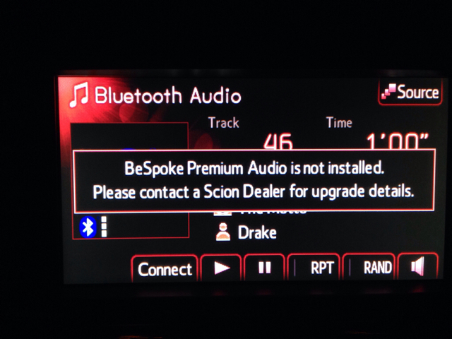

DIY 2014 Navigation unit **FULLY working 6/19** Pandora/Weather/Traffic/ETC...
So I'm confused.
I bought a late 2013 FR-S which comes with the same model head unit as the 2014, which supports navigation. I believe it's considered the BeSpoke but I'm not sure.
Can I just add a GPS antenna to this? ( model pioneer t10015 )
This message pops up when I press the maps button.

Originally Posted by Tillman32 View Post
So I'm confused.
Attachment 53825
NO, you will need to buy the extension box, gps antenna and bracket to enable the navigation.
