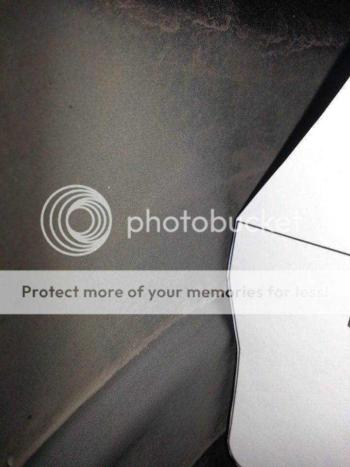

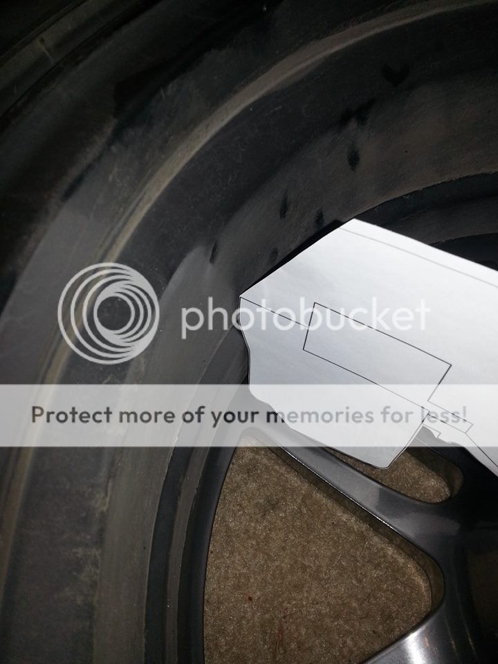

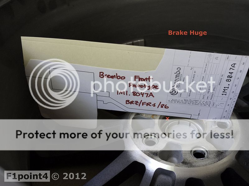

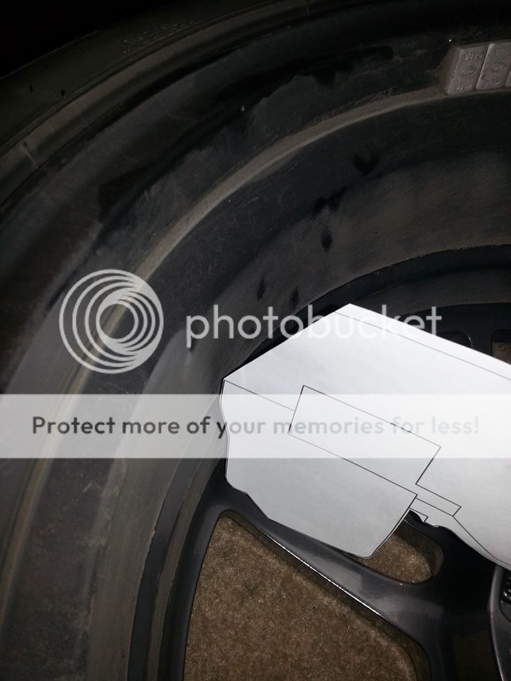

RPF1 18x8+35 fitment
I used this template
vvvvvv
am wandering about caliper expansion, if any...
