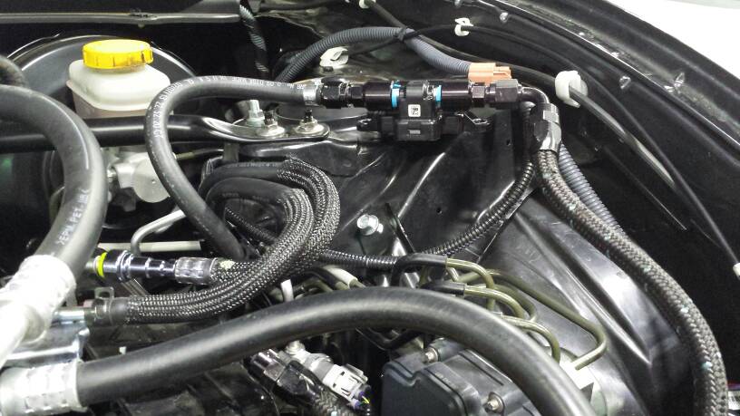

Installed the updated sensor, mounted it and replaced the questionable line with the correct size one. Used the speedflow AN to 5/16 barb I got from Australia.
Not one of wiff of fuel after the install. I hope this is it for any worries.
