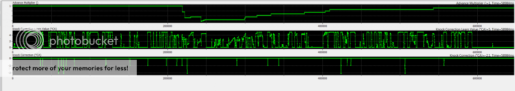

knock correction
Here's a screen shot of a log I did today. Not great since I started it in the neighborhood and then passed a cop as I started opening it up. I have a few different tunes from some different tuners, but I've been rocking this one for about 2 months. It feels the best to me. Any of you professional knock correction readers see something majorly wrong?
Looks good. You have three events of -1 correction which isn't anything to worry about.

And if I'm not mistaken positive numbers in the knock correction learn value are advanced timing? Meaning +5 is advanced timing, -5 means pulled timing?
Yes.
