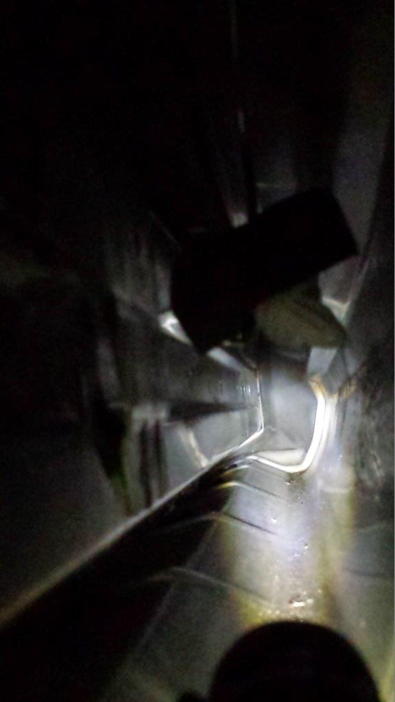

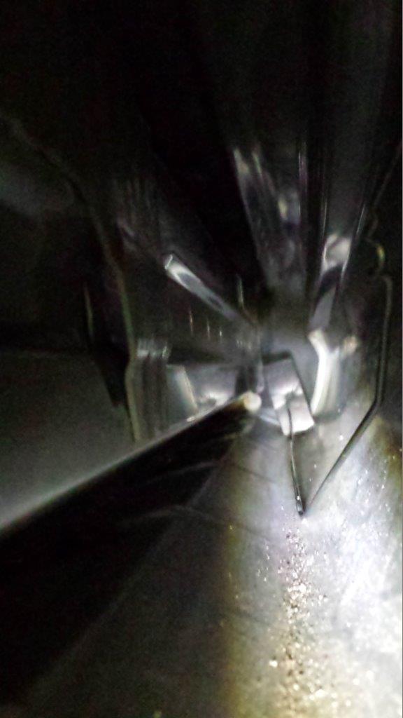

If you take off the rear plastic panel (where the rear speaker is), you will see a big hole where the rear speaker is.
Stick a small torch and a camera in that hole and start snapping, you may be able to find clip in there some where.
To get it out, I used a double sided tape (foam type) at the end of TWO coat hangers stuck together to get it out. I needed two coat hangers as it was too deep
First picture shows the clip near the front wheel arch, the second photo show the clip on the double sided foam tape.
I think I took about 30 photos trying to get close to the clip.
