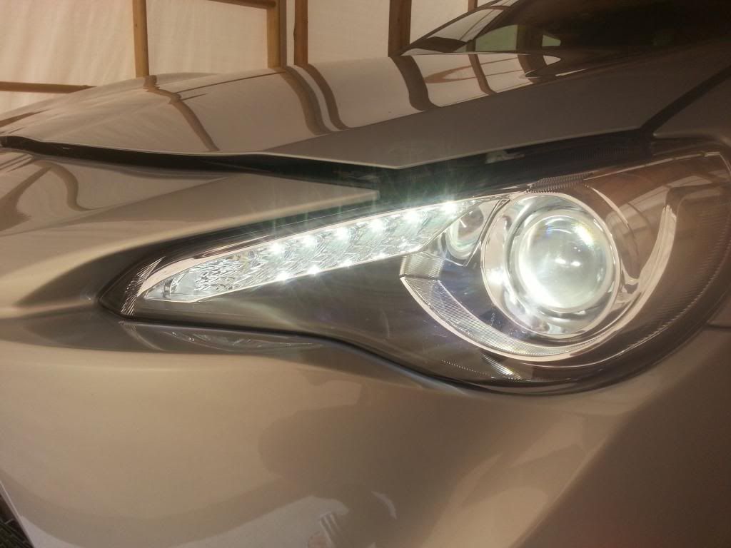

You are right Luis_GT, our cars do not have LED low mode.
Before:
After:
All I used is two diodes. I didn't get to shrink wrap and clean it all up yet. Fully reversible if the car needs to go in for servicing.
Two diodes in parallel between pins 1 and 5 did the trick. Diodes are used to prevent the HID ballasts from turning on when the DRLs turn on.
Before:
[IMG]http://img.photobucket.com/albums/v306/Projek_01/20130806_104233_zpsa4d31a16.jpg[IMG]
After:
[IMG]http://img.photobucket.com/albums/v306/Projek_01/20130806_104127_zps93c56e45.jpg[IMG]
[IMG]http://img.photobucket.com/albums/v306/Projek_01/HIDHarness_zpsef5db36a.jpg[IMG]
Well... that's a damn simple solution... but are the led's in low mode of or high mode with the headlights on?
