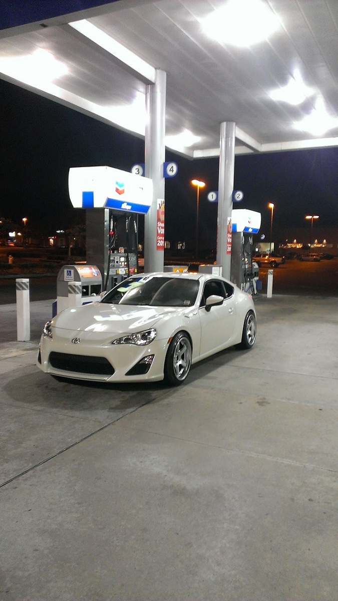

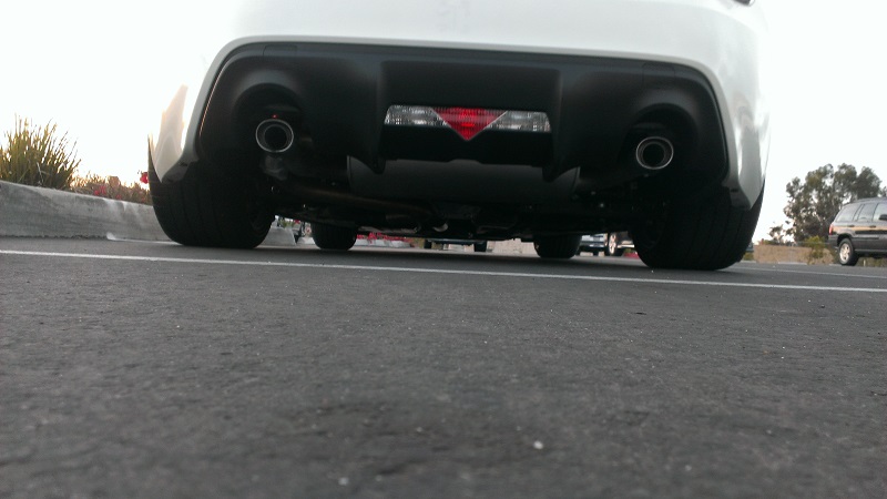

rota rt5 18x9.5 +38 all around
235/40 front 255/35 rear
b&g springs 1.4in drop

any reason you have a swquare setup but ran a stertched tire up front? you can fit a 255/35 all around man!

yes that will work, as mentioned in my first post trim the rear bumper tab (opr let it rub itself out) and roll/fold/push in the part that flares out by the side marker.
however i'd go with a 245/40 in the front isntead. to fit this you'll need minimal camber
