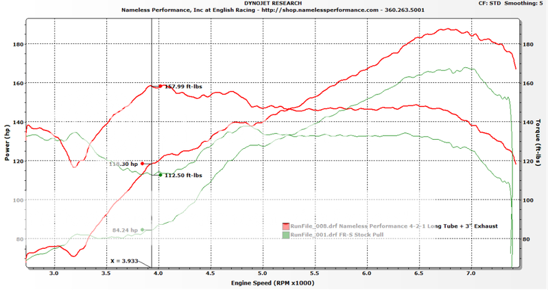

I haven't seen anything about the intake casuing it. Its been a combo of tune plus a good header, but nothing by itself. My tune alone helped, but it was still there. Then adding the header helped even more, but it was still there. Once the tune was readjusted for the header, problem solved. It may have to do with cam and ignition timing with the header.
Here is an example of a good equal length header and a tune...

Nicely done. I hope to meet up with you sometime, I would consider doing what you did. I am not looking for 300whp for a daily driver, this looks just about perfect.

This is the Nameless long tube header with 3" exhaust. This particular header is not out yet...but just showing an example of what the right header and tune can do.

That would be great! This isnt my exact set up thought. This header is not in production yet, but soon. I am running an equal length header and tune, the torque in the dip area feels pretty flat. This is the only dyno I have with the header and tune, but keep in mind, this was just slapping the header on. It has now been tweaked much more...I have yet to dyno it with the new tune.
