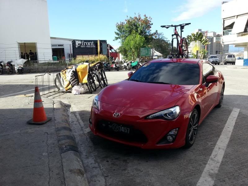

The 86 is my only car, so it has to do everything for me
After a particularly harrowing mounting experience with a B and B rack:
I decided on getting Sea Suckers haven't looked back since! awesome and easy to mount/dismount!

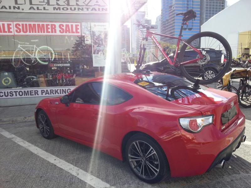

I had some roof bending when I mounted the front forks to the roof.
I compensated by mounting the front forks onto the glass and rear tire to the roof (rear mount is only to hold rear in place and keeping it form swinging - not a load-bearing part) - never had a problem with it since reversing the mounting.

If this is true, I do compensate by mounting it near the corner of the glass - to keep it at the part of the glass with the strongest structural rigidity. The weight of the bike (roughly 30 lbs) is spread out on 3 suckers for the front fork and each sucker is roughly 5 inches in diameter, so I am hoping it won't be an issue.
