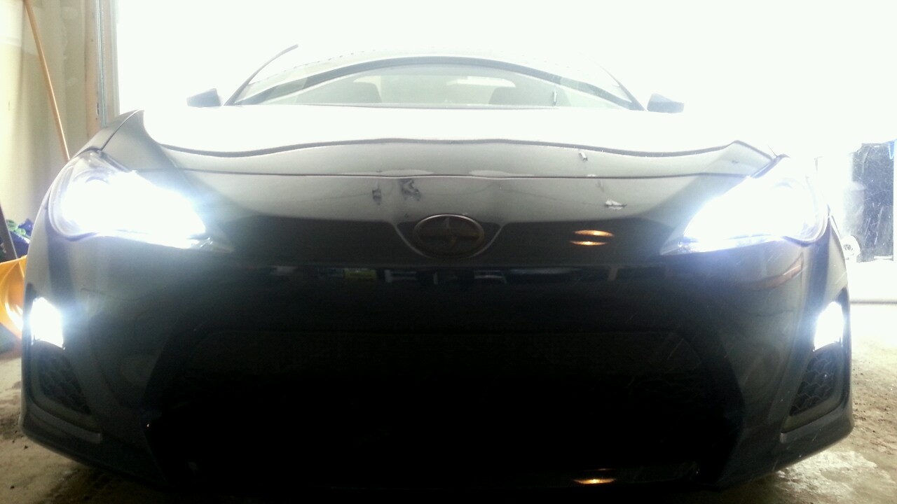

First try uploading a pic from an iPhone, This is the sylvania zxe H11's..

looks good.
Try shooting from a distance and from the side where it shoots a wall.

Here, now that I'm on a PC this is a little easier...!!
