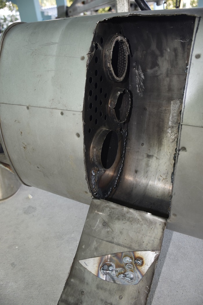

OK,,, did a bit of playing around with the IPhone DB meter on my wife's phone, certainly seems to work based on my WROOM WROOM noises. I should be able to show a difference between the two,, that is stock versus my modified muffler but in the end it'll be hard to tell. The fact is you'll need to base the sound level on all the mufflers to really get an idea. I also cut the plates to cover all of the holes in the OEM baffles. The question is do I cover all of the holes,, that is both sides or not. If I cover both sides,,, does it become a muffler delete?? I mean the sound waves will be bouncing around a bit but will it be too much??? I should have it done and welded up this weekend,, after building the fence so we'll see.....

My friend did it, cut open the muffle at the OEM welding points, remove the perforated pipes inside and replace them with an straight Y-pipe, weld back again, just that.

I welded in the plates covering the holes in the baffles. Plates may be too strong a word for 22 gauge metal as I kept burning holes through it. If there was a next time I'd use something thicker as it sure make it easier. I ended up covering most on the one side and half of the other. Hope it's not too loud,, don't really want that. The fence post caps are supposed to be here today, if so I'll try to get those in and weld it up by tomorrow.
