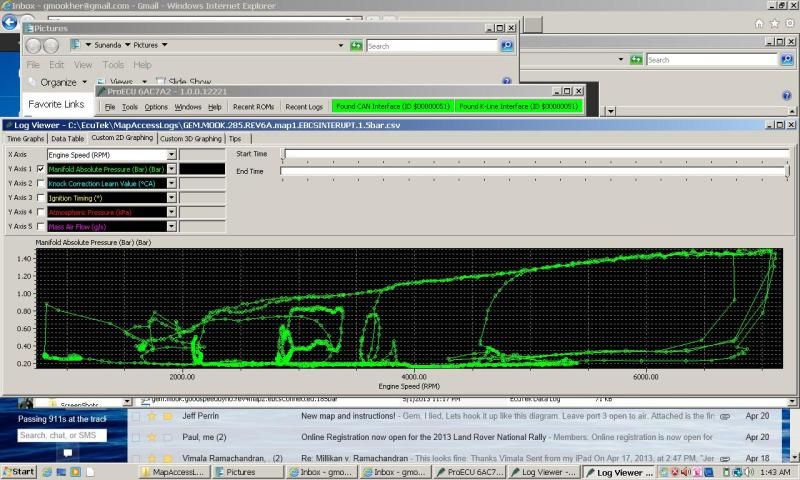

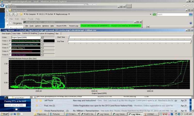

A little update from Gem,
great news
got ebcs working!
heres what it looks like -fun pics, boost on my pulley hits 1.9 bar=27.55psi
1.68bar=24.36
ambient is 14.8psi today
I getting the joy of a 13psi capable pulley up to 6000revs
the safety of 9.5 psi at redline
map1 is valet mode no ebcs only 7psi boost thru whole curve
map2 adds ebcs
maps 3 add more timing/need better fuel to really use those
gonna test this backwards and forwards then redyno
