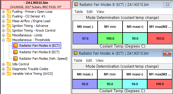

At least the fans are working when AC is on, it belongs to the ECU.
The fan could run at 103 C without AC in some conditions.

Thanks Makinen, so what I should be checking next is to confirm that my ECU is at least reading the correct temp. I'll see if I can borrow OBD tool from a mate. I would have thought that if the stock dash gauge is showing the correct temp, that the ECU would be seeing the same values, but maybe not???
Do you know when Fan Mode (A) would be selected over Fan Mode (B)? As in, what are the criteria where one would be selected over the other? And out of curiousity what are that parameters under the Vehicle Speed Fan Modes? I wonder if I have a speed sensor issue at low speeds that is preventing fans from turning on?
Attachment 222654
Attachment 222655
IINM - the low speed and high speed fan triggers are between the 1st and 3rd box, and the 2nd and 4th box respectively. A and B tables represent with no AC and AC from what I recall.
If it was a speed sensor issue you would have ABS/VSC lights on the dash.
Depending on the tool you've used, you can see the ECU trigger PIDs along with the fan motor PIDs which should help you diagnose if the ECU is requesting the fans to turn on.
