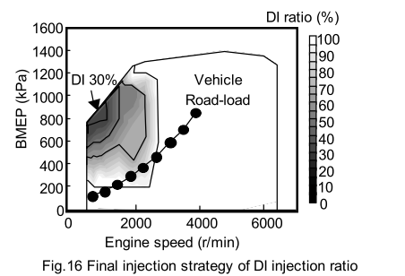

So I noticed on some other forum arghx[7 here presumably?] wrote that simply increasing port fueling would overheat the direct injectors... Can anyone explain? At high load the direct injectors are the only ones turned on, so fueling would be direct injector limited in this case :O
Let me preface this by saying that I don't have a crystal ball and I don't know what will happen in the real world when somebody actually tries to crank up the port injectors at full load and high rpm repeatedly. There might be increased wear of the direct injectors in a slow and noticeable fashion. There might be random and catastrophic failures. There may be some negative effect that is difficult to quantify and barely noticeable--negligible in essence.
With all that out of the way, allow me to post the material directly from the source paper on the IS350 2GR-FSE engine:

Do you have any idea as to what causes that? I have heard of direct injectors being fired at intake stroke, beginning of compression, or later in compression. If it's later in the compression stroke then mixed fueling would mean less fuel for the direct injector, and that the injector would have less cool down time while the cylinder temperature is high. Injecting more fuel during the end of compression stroke would allow the injector to stay cooler when ignition happens and probably would keep temperature down. The dish guided spray thing seems to suggest injection happening at either beginning of intake stroke or end of compression stroke, the only 2 times you can put fuel in and have the piston near the top.
The problem is I seem to remember being confused about these D4-S articles because there was conflicting information on how the injectors actually operated... At any rate, I have trouble seeing why increased port fueling while keeping the direct injector running the same could cause overheating. More fuel, even through the port, would be expected to lower temperatures across the board I think that article is talking about why they necessarily HAD to run 100% direct injection at higher speed. I guess that brings a second issue though, forced induction would increase cylinder temperatures considerably and 150C sounds pretty easy to hit if they are relying on the fuel to cool it down during the very short time that injection happens in :O

Sounds similar to urea injection issues that were happening with diesels...deposits and temp regulating. As stated, higher fuel flow will help keep temp down. Then we also can keep in mind for FI that the peak temps are higher but not necessarily as hot as long.
For now it's all speculation to limits, etc. Seems Denso is running higher DI duty cycle because they can't make an injector to take the temps.
