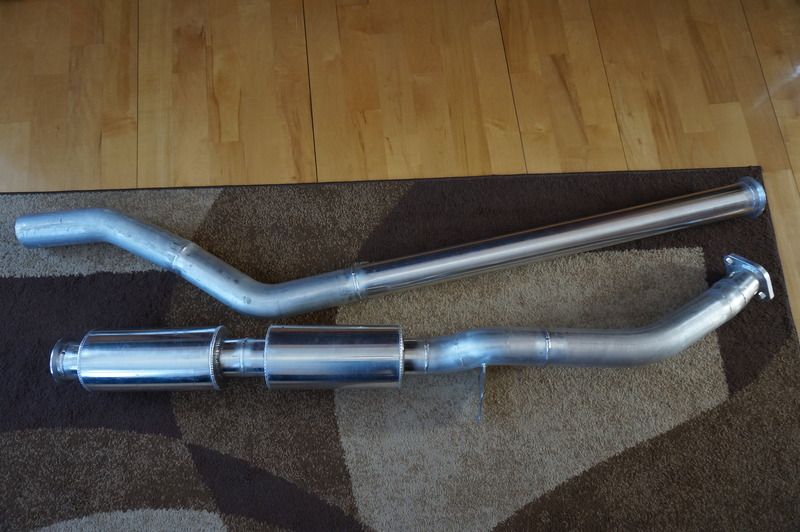

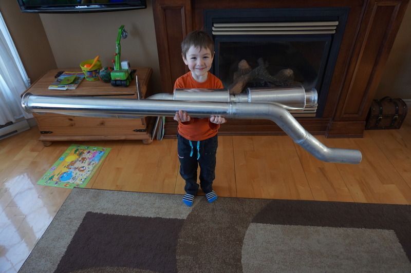

Didn't updated this in a long time but we just started working on it again, here is a teaser, full aluminum exhaust, from the overpipe to the back, center exit
Picture of it and the 4 years old full exhaust lift, yeah it's that light, we'll weight it later

well total weight of the exhaust is precisely 11lbs, i beleive it is a saving of over 45 lbs from the factory front pipe and rear section. Only thing left to do is a tail pipe which might be made of carbon fiber, the owner is crazy about that stuff...
