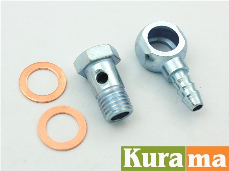

So a thought I had while performing this mod, was concerning the bolt that connects the banjo fitting to the cylinder. It has a hole running through the threads which presumably needs to line up perfectly once tightened down. Do the threads on the bolt itself ensure this? What if you were to over-torque the bolt? Or am I wrong in assuming it needs to line up perfectly?
No they don't need to line up perfectly, the banjo fitting has channels cut inside to make sure it doesn't matter.

That was a good question so I dug up an example. Sometimes the groove is cut into the bolt. I haven't seen much of that. Most fittings are like this, where there's a cavity cut inside the fitting.
