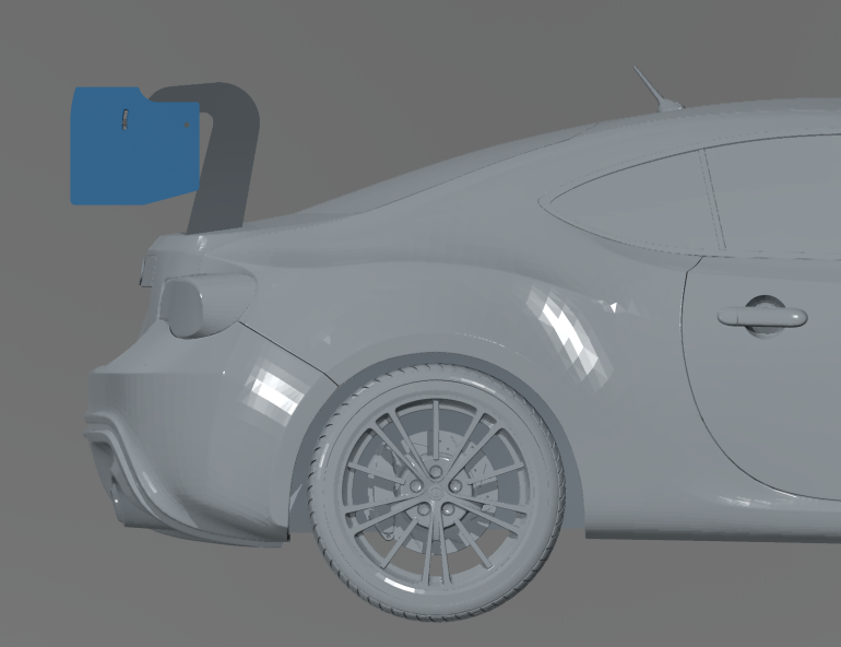

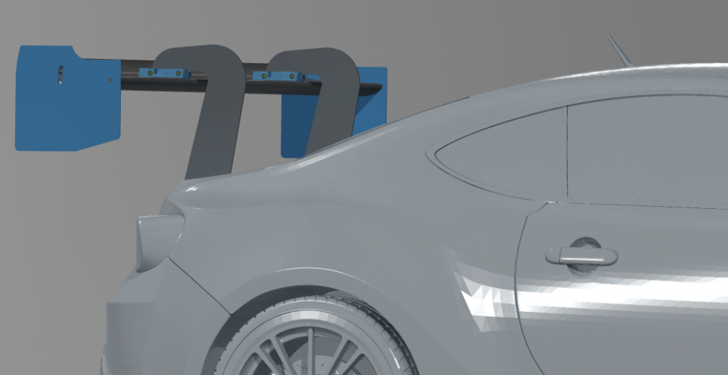

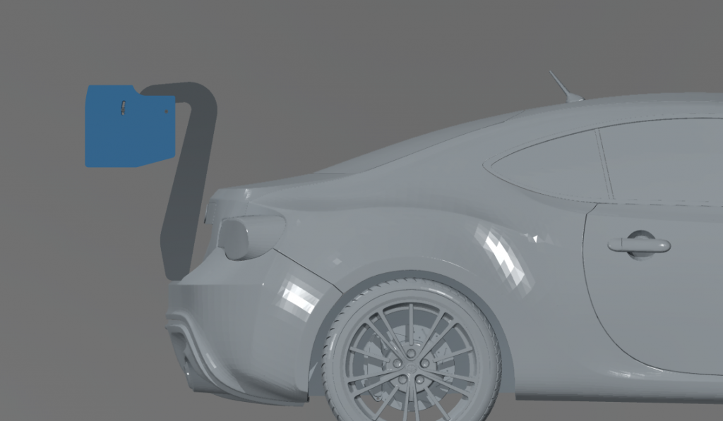

What do you guys think of wing mounting locations? I have two different designs I am working on, a trunk mount and bumper mount. I personally like a bumper mount because it has more positive in my opinion. Let me know what you guys think...
Trunk Mount:
Bumper Mount:

Bumper mount would be tricky if the customer has put on a new body kit with different angles. All of the trunks that I've seen have used the same OEM angles.
Personally I think the bumper mount would work better with aero but trunk mount looks better and usability of the trunk is not compromised.
