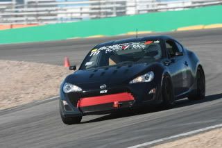

Originally Posted by Ben_G View Post
Do you have pics of the taped up front end?
yes

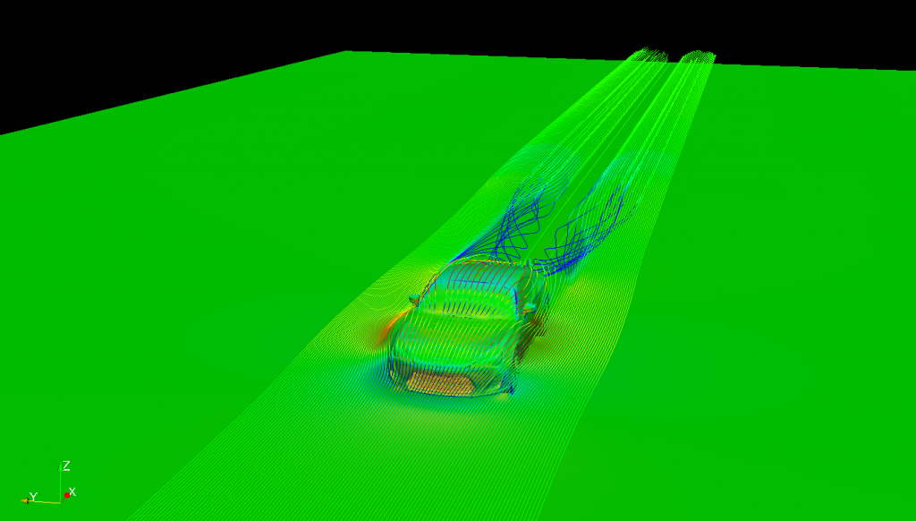

We're finalizing the design on our single element rear wing at the moment. We're also developing a dual element wing, but that's a bit more extensive. That's all we have in the aero pipeline... for now.
Since everyone loves colorful pictures

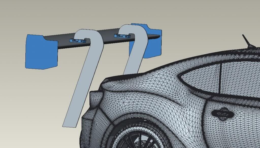

Originally Posted by AlvinT@Borla View Post
More updates? Thanks.
I have been working on finalizing a single element wing. Don't mind the crappy quality (screen shot) and the mounting isn't finalized. The swan neck mounts are just for representation right now (work in progress)
