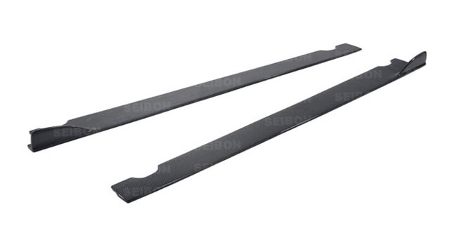

Vertical Fins
For you experts, is there a purpose to the vertical fins, on side skirts, and lips. They can't stabilize the car, as they are too close to the side. Do these help with drag around the wheels, or do they just look good?

I've seen these on the McLarenn P1. The vertical fin is just downstream of the front tire. It's combined with a larger vertical fin that runs along the body.
My guess is that the swirling air coming out of the wheel needs to be re-stabilized and directed rearward.

Most if the fins are located just before the rear tire on the kits for these cars, so it's not serving the same purpose as the super engineered McLaren.
The thing that side skirts really do is limit the air coming underneath the car from the sides such that stability is gained...at least from my very basic understanding.
