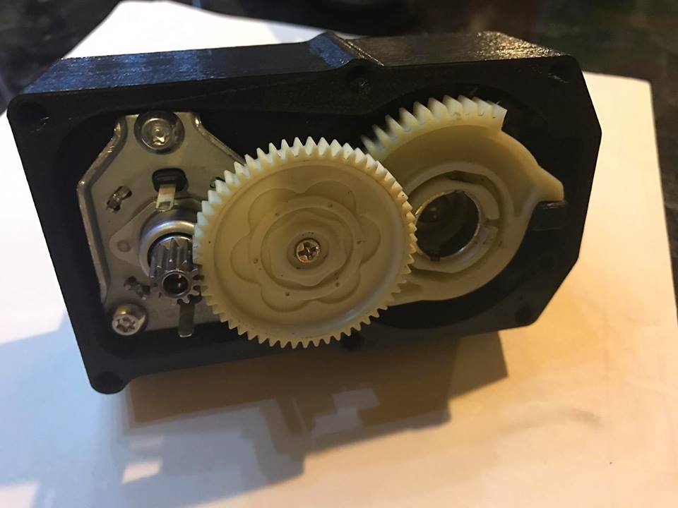

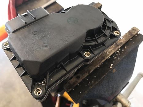

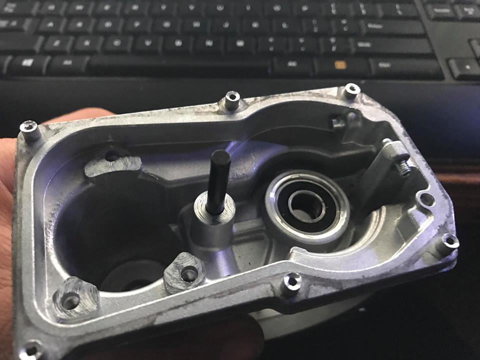

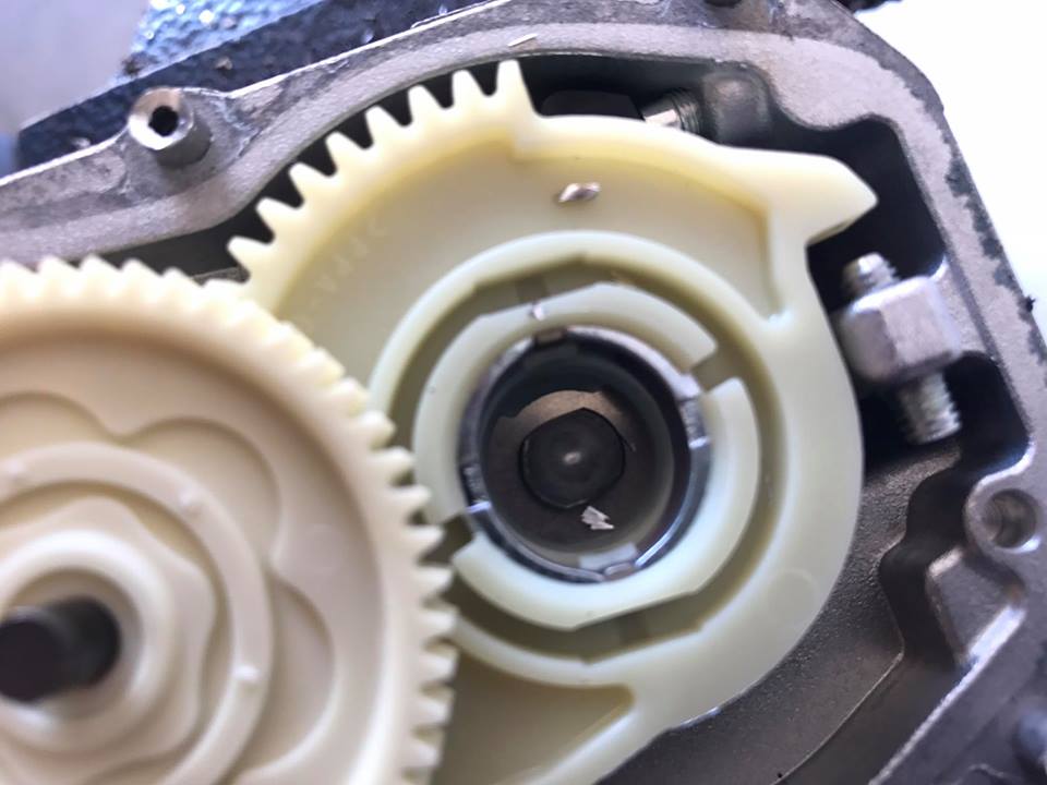

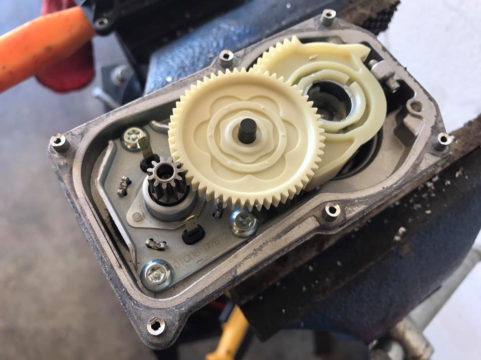

Now to incorporate the DMW Motor.
Tore this down to figure out how it works.

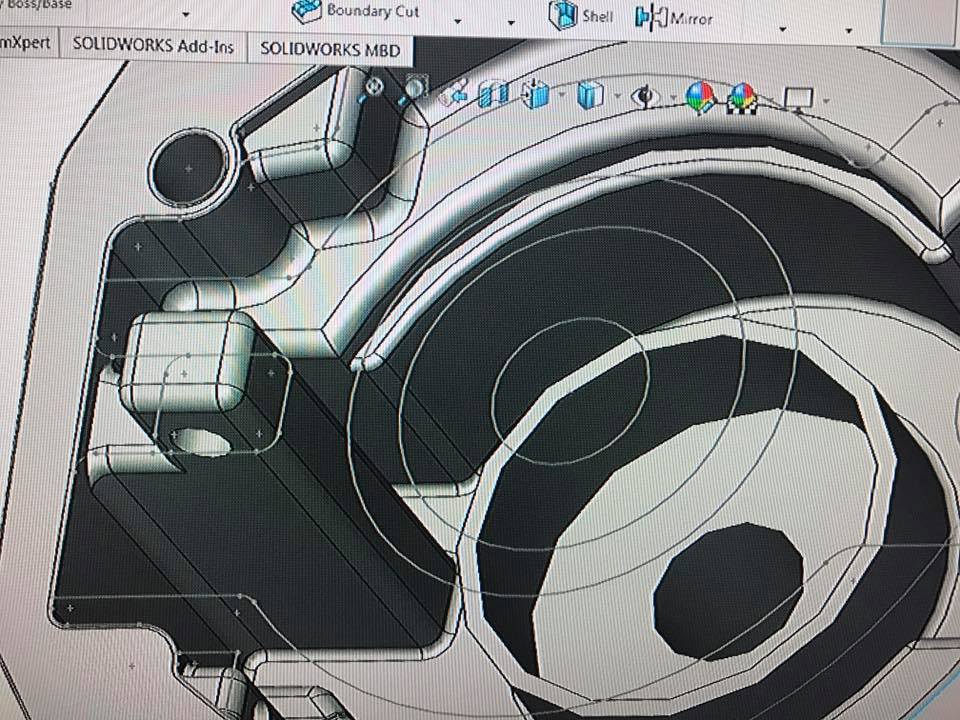

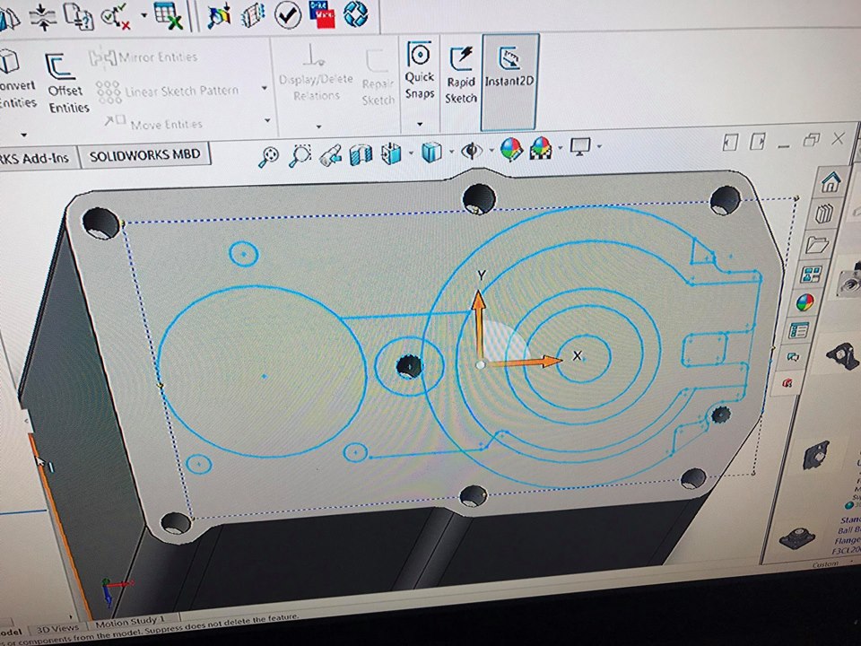

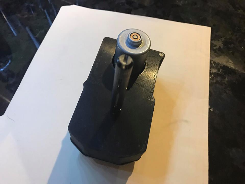

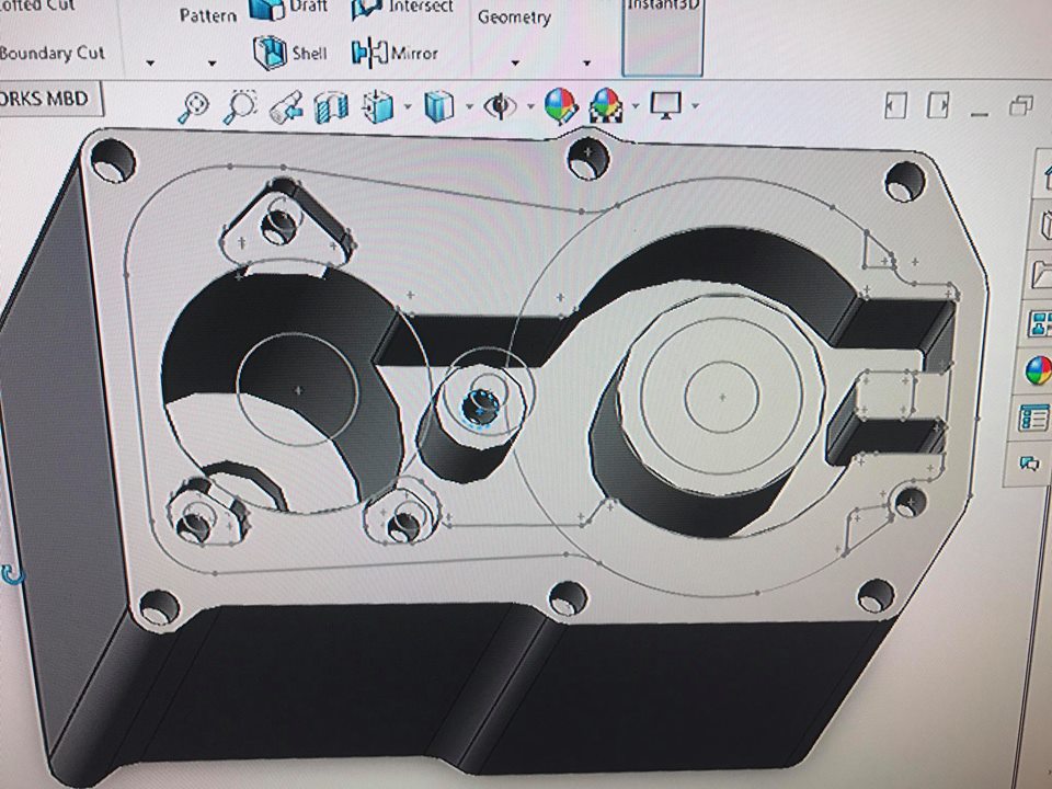

Amazing what a set of calipers and some patience can produce.
Ill get some more pictures of the entire housing so you can get a better Idea but this took me about 3 hours to measure out. only had to tweak it twice after 3d printing pieces for test fitting.
Never thought I would use pythagorean theorem formula after High school... glad I have a good memory, and or google...

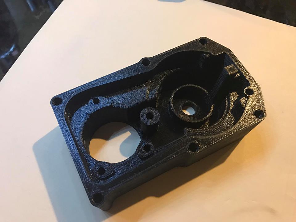

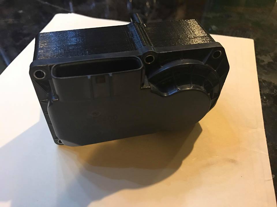

Taking shape.
3d Print starts this evening for test fitting the OE parts in the case

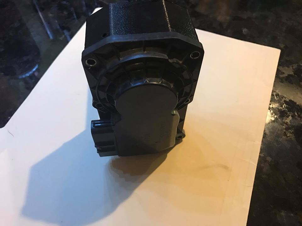

And here it is perfect fit!
