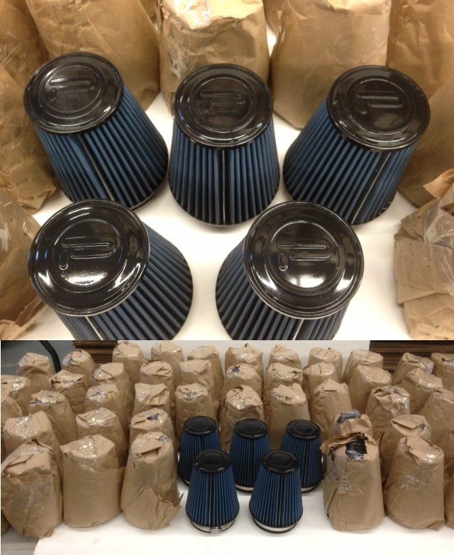

We'll get those performance data in more detail once we setup the VBOX.
In the mean time...here's the custom PTUNING cone filter for the FRS Turbo System.
