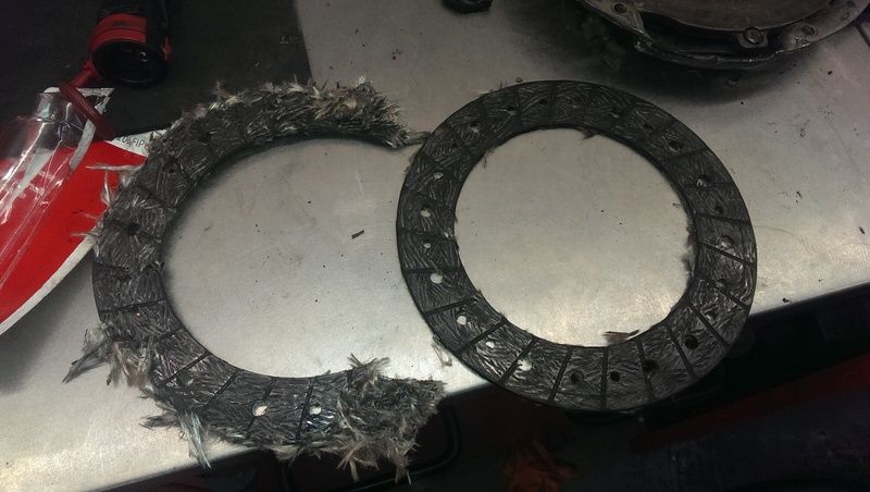

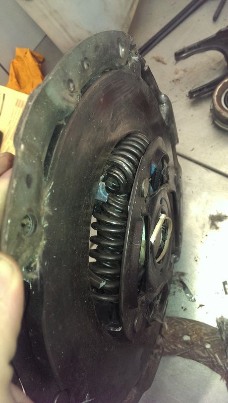

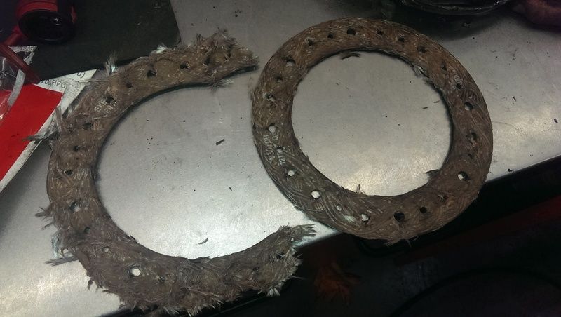

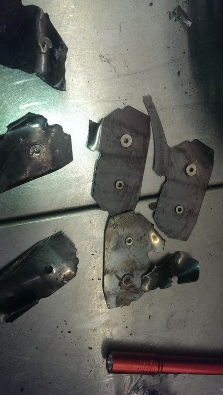

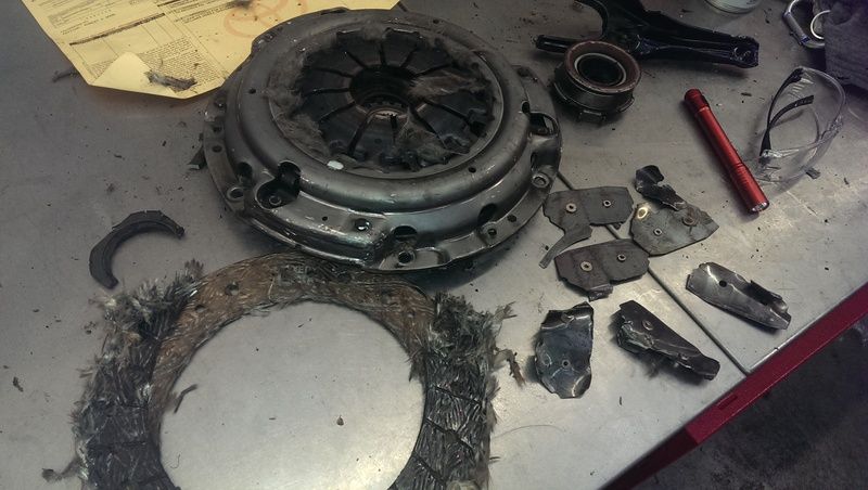

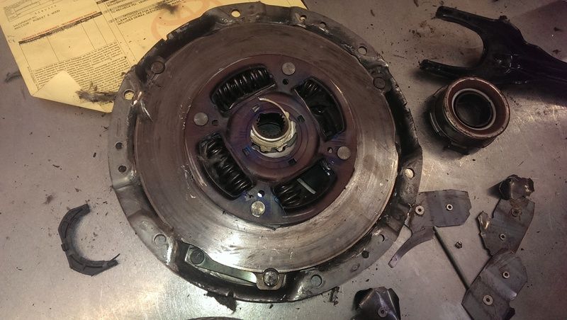

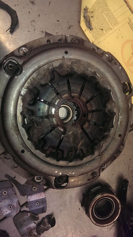

Ok so the car is now apart and I'm waiting to hear if it will be covered.
as i suspected things look quite a bit like what others have posted
here are some pics of the damage
other then the images the bell housing has been scuffed up pretty good, the flywheel is in good shape with no discoloring, and a piece of the clutch got lodged in the starter.
I should find out tomorrow if it will be covered or if ill need to fight some more before i can get it all fixed up.
here are some pics of the damage .............
Now THAT is what I would call a "blown clutch" ......
Yep, something came lose in there fer sure.......
I would think a clutch, under the conditions you mentioned, should not blow up ..... maybe get burned up ...... but not blown up.
You just tell that to the dealer ...... and that ol humfrz, from the forum, said so ......

WTF, the friction plate (if that's what its called) is disintegrated? No way that's normal. It doesn't look burnt up, but fragmented.
Buddy had one go just like that on his Evo a few years back. We reconstructed it like a crashed plane and determined one of the rivets had popped and ripped the whole thing apart.
