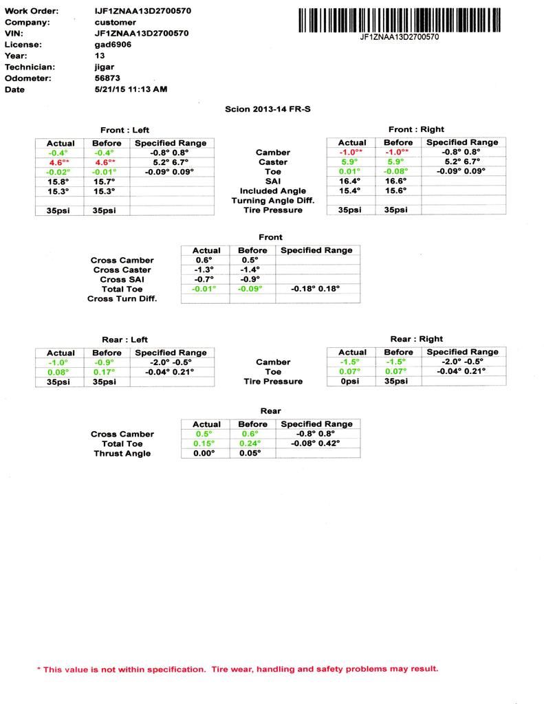

I had an alignment done before the issue started, after the issue began i had the alignment checked again from a better shop, the alignment was fine, except my caster on the left was 4.6, where the range is 5.2-6.7. The right side is 5.9 - in the range. The car was in an accident close to three years ago, the left side had a damaged wheel, but an alignment showed it trek straight. I don't have specs, so who knows if the caster was off the whole time?

what are your FULL alignment numbers after checking with the better shop?
Here are the specs, stock suspension.

The caster is definitely an issue, anything greater than .5 degrees left right will start to exhibit pull to one side. It will also affect the ability for the car to center the wheel
