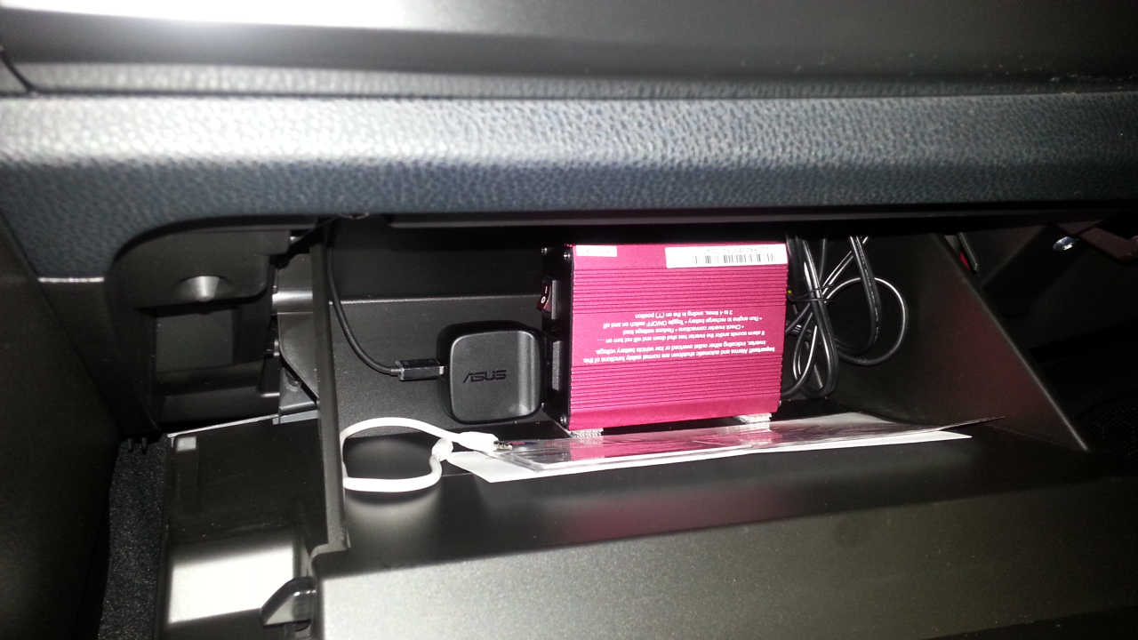

I was able to find a mini USB charger that charges at 3.1amp which is for the ipads and it works fine with the nexus 7 tablets.. i dont need an inverter in my glovebox

This will also charge it, if you are looking for a part number:
http://www.monoprice.com/products/pr...seq=1&format=2
The 3.1a is good too, do you have a part number?

a 3.1m mini is a dual USB port charger.. one is 2.1 and other is 1.0 which i can still charge another thing like a cell.. but its charging, but when you use an inverter is your always "awake" does it dim?
