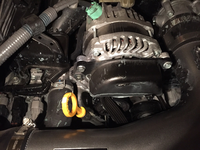

You can see the plastic alternator cover melting from the friction from the slipped belt here.

From the sequence you describe, it could be that your alternator seized a bearing (initial odd noise and charging system light), causing the belt to overheat and eventually break (temperature going nuts and power steering failure some time after the initial event). The fact that the alternator's belt cover is melted says that something bad happened there to cause heat. A simple broken belt wouldn't do that.
