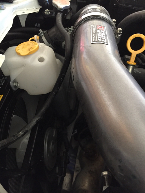

mit_peid 01-25-2015 01:34 PM
Attachment 101226
From what I can tell I think the coolant was coming from that hole on the reservoir cause it was so hot. The actual coolant was still at the max line so probably didn't lose too much coolant yet.

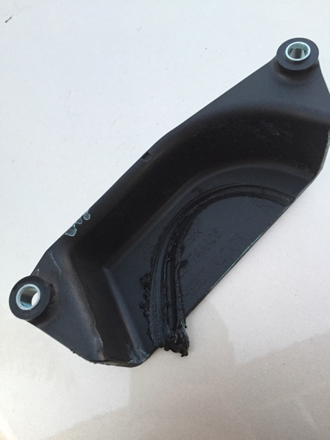

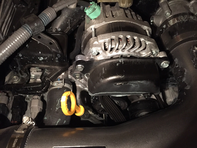

mit_peid 01-25-2015 01:40 PM
Attachment 101231
You can see the plastic alternator cover melting from the friction from the slipped belt here.

FlamingRectumSyndrome 01-25-2015 05:08 PM
Check that the alternator pulley rotates freely.
From the sequence you describe, it could be that your alternator seized a bearing (initial odd noise and charging system light), causing the belt to overheat and eventually break (temperature going nuts and power steering failure some time after the initial event). The fact that the alternator's belt cover is melted says that something bad happened there to cause heat. A simple broken belt wouldn't do that.

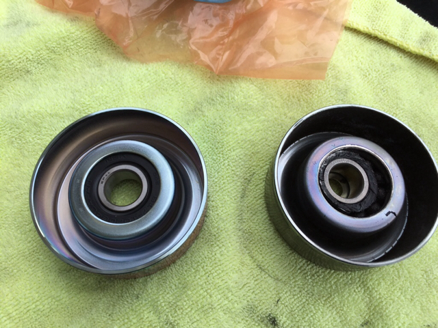

mit_peid 01-25-2015 08:22 PM
Doesn't seem like the alternator pulley is seized as it can freely rotate, but with the expected amount of weight. Here's a photo of the inside of the pulley cover. Any recommendations on brands for new belts? OEM or GATES?
Attachment 101280
