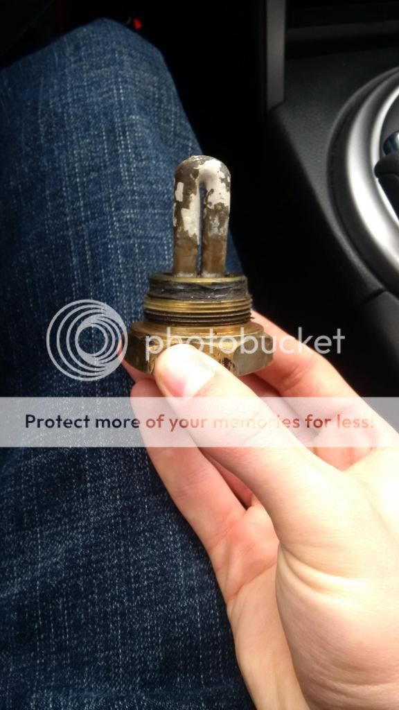

Ive gone through 2 block heaters since I got my FRS last feb. I had it replaced in December and then again 3 weeks later. No idea what happened other than it cooked itself. Subaru and Toyota can not understand why 1 let alone 2 failed.
Here is my original one that came with the car.

I wonder if it has something to do with ambient temp. When I tried the 2nd block heater, I had it plugged in for 4-6 hours but it was only around -10C. Maybe it wasn't cold enough and that caused the element to get hot enough to create air pockets around it? The week after I killed the 2nd one, the temps dropped to -25C ish. It started up, didn't like it, but it did. I agree, beater next year.
Admittedly I did have it plugged in while it was only -1 outside. That shouldn't create a problem but I suppose it did. (It was -12 the night before)
I guess that could be my culprit..
