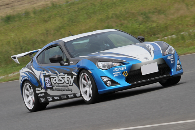

BRZ HID head lights on Toyota 86/FR-S
Yep it fits, actually looks pretty good:

Looks really good. Anybody doing this conversion on their fr-s?

i love those TE37SL

they look amazing on the 86

Do you need that many turn signals lol?
