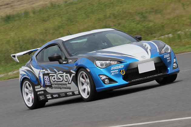

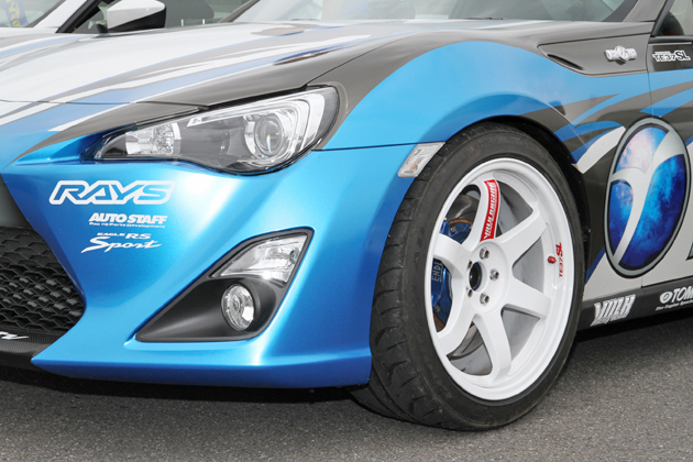

Yep it fits, actually looks pretty good:
Attachment 9406
Attachment 9407
Attachment 9408
Thatoneplz 06-26-2012 08:03 AM
Looks really good. Anybody doing this conversion on their fr-s?
BoxRZ_86 06-26-2012 08:04 AM
i love those TE37SL
adprokid 06-26-2012 08:58 AM
they look amazing on the 86
tripjammer 06-26-2012 09:29 AM
