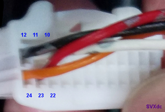

Here's a rotated/cropped version of your picture, with pin numbers added:
The colors appear to be black, white, orange, red. Is your picture from the harness in your FR-S, or a pic you found elsewhere?
Would you please confirm the colors you saw, and match them to the pin numbers?

Good catch SVXdc, I mixed up the colors between the dash and trunk harnesses.
Trunk Harness at Camera (four pin):
Colors are for the harness plugging into the camera pigtail wiring.
2 - Light Blue Camera Video -
1 - Orange Camera Video +
4 - Brown Camera Ground
3 - Yellow Camera Battery +
Dash Factory Harness (24 pin):
24 - Orange Camera Video -
12 - Black Camera Video +
23 - Red Camera Video Ground
11 - White Camera Battery +
Let me know if you have any other questions. It would be easy for me to take a picture of the trunk wiring.
