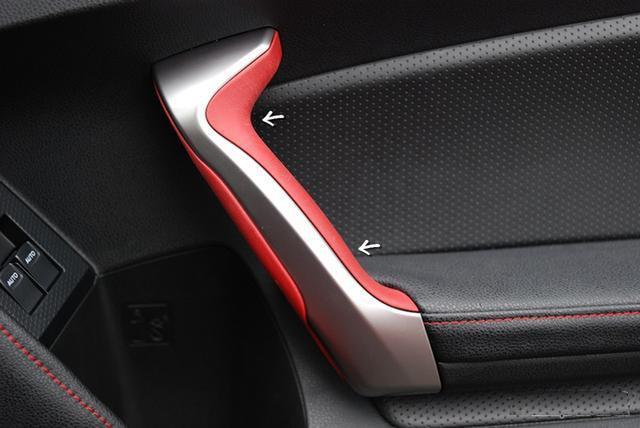

how the heck do you install these? anyone have a clue?

You have to take the entire door panel off and get to it from the back side...
See aluminum bar with the two screws holding in the handle piece in the picture below (which I borrowed from this thread: http://www.ft86club.com/forums/showthread.php?t=32694)

Man those are nice! I'm not trying to take off the whole door panel though. Scary!

ahhh shittt.... well it's not that bad right you just have to unscrew all the screws around the door and the door panel comes out right?

All those little white circles on the picture you quoted are plastic clips you will have to carefully pull on to remove the panel. Count on a couple breaking if you haven't done this before.

Do it when its warmer, like all plastic, these white clips are harder to work with in the cold and can easily snap. But even if they do they are extremely cheap to replace so just be careful and not break the place it holds the white clip. You can break every single clip there is and it'll be less than $10 to replace all of them. Also remember that there will be ALWAYS screws or bolts thats holding the panel and not just the white clips, so don't start pulling the panel unless you know the screws and bolts are all off.

its getting warmer and i'm going to do this next week when my JDM Speaker grill and ring comes in so i can also install my jdm red stiching speaker pads.

they call pop rivets, there is 2 sizes that i found they used in panels. I bought 50 each and bill came to like 14$ lol

do yourself a favor too and get the pop rivet removal tool for those pesky ones that do not pop out. Will save the pop rivet from prying damage and money replacing them. Agreed on cold weather removal. Do not forget about the electronic door locks and for the limited guys, the wire for the door vanity lights. It is more than just pulling the door panel off. It is easy, just watch what you are doing.
