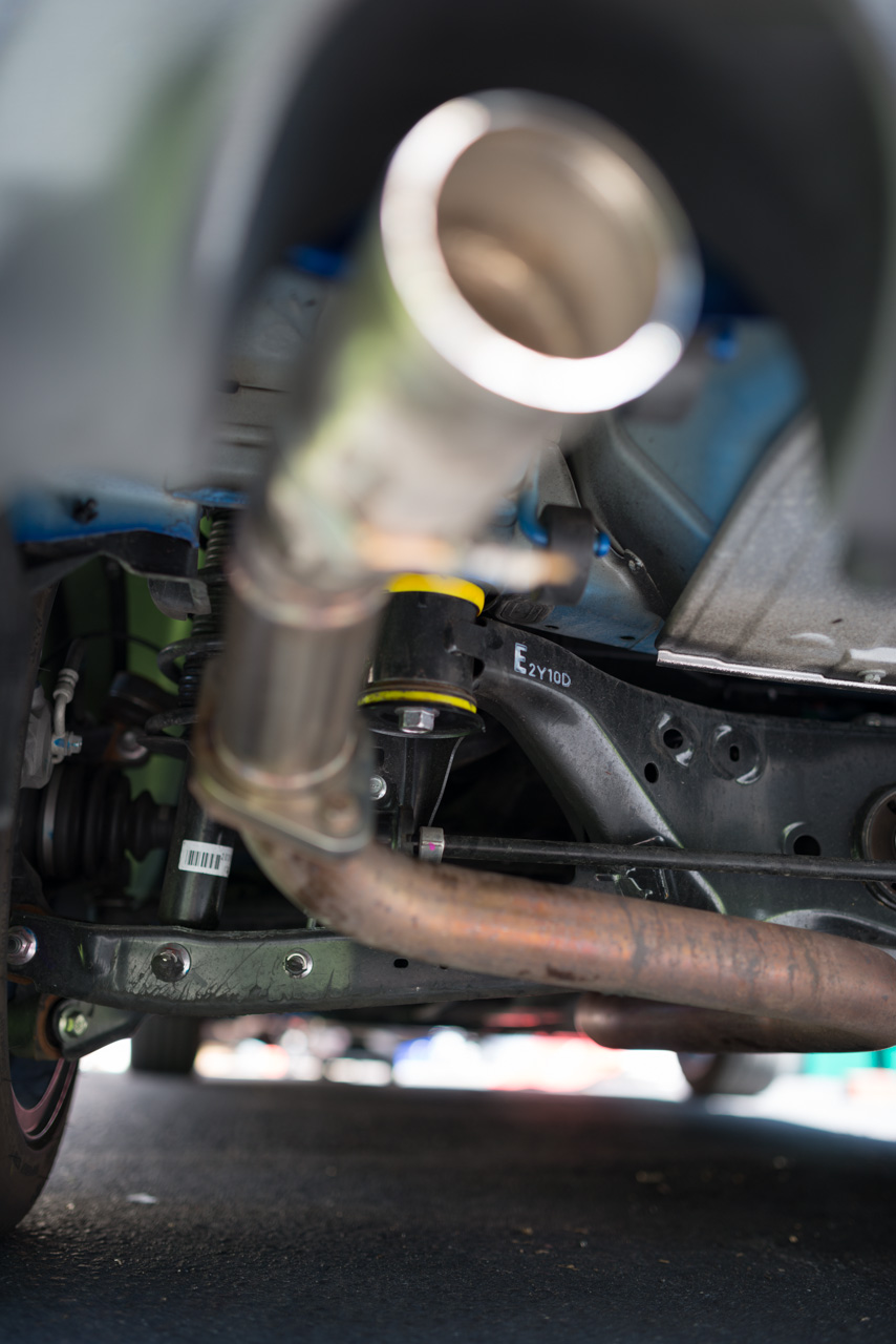

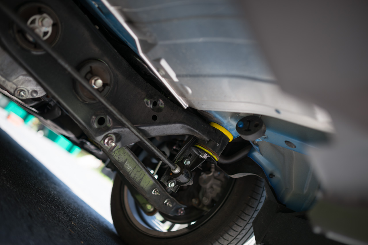

So despite being the daily some things are frustrating and must be taken care of. Surprisingly the suspension has a nice stiff spring rate, and well dampened; but as I mentioned in another thread, the diff is hung by bubble gum and leads to awful response in the on/off throttle area. So we did as any responsible parent would, and in the name of safety, upgraded the bushings. So far we got the rear subframe and power steering bushings in place. Able to do it with a c-clamp and not need any special tools in the front, the rear was easy as can get. Was going to do it on the lift but it ended up being quite easy on the ground and took less time than the drive to the shop. The "assistant" unfortunately shed some tears at the sound of an impact gun, so we were delayed just a bit here
Whiteline inserts

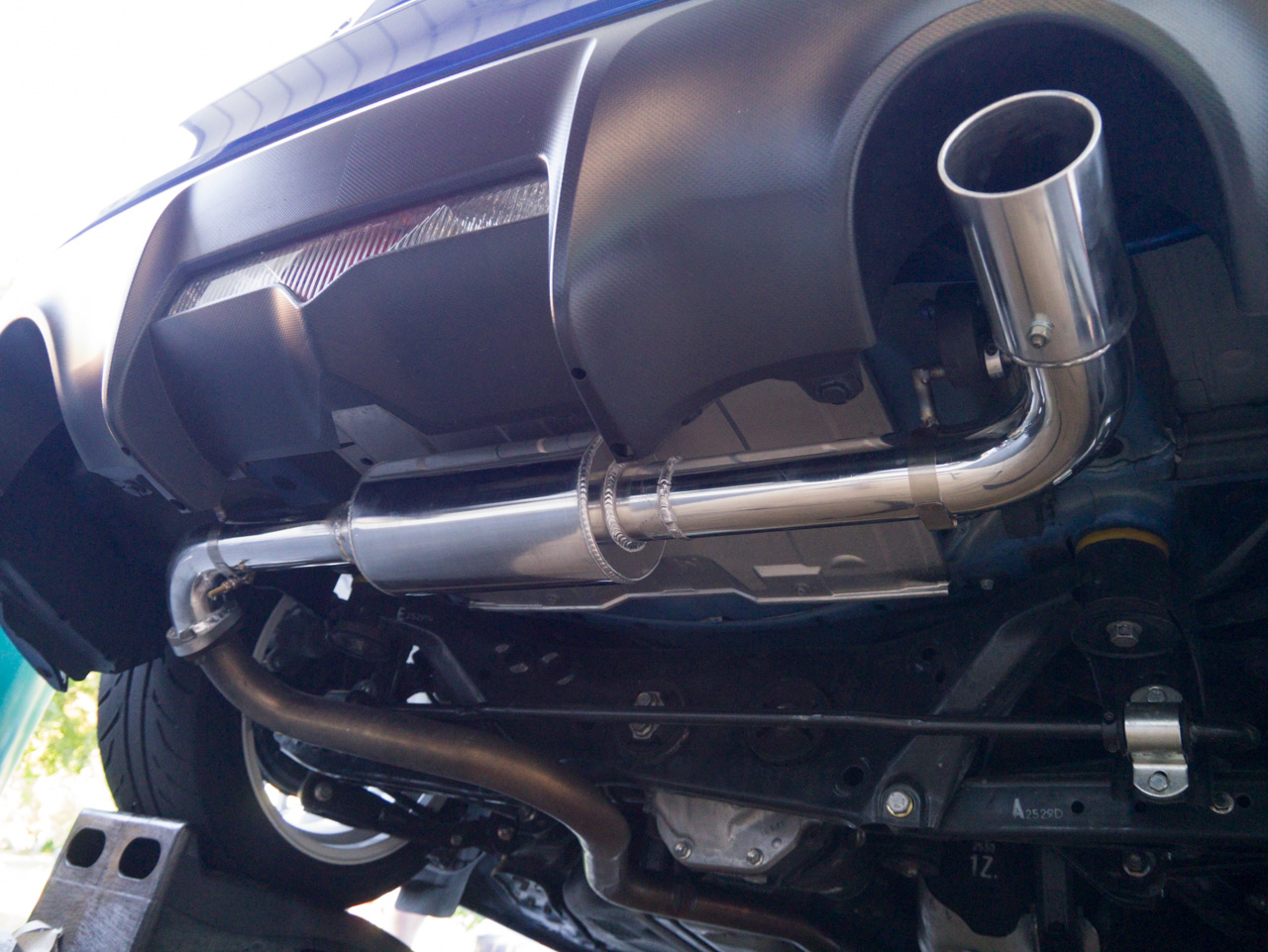

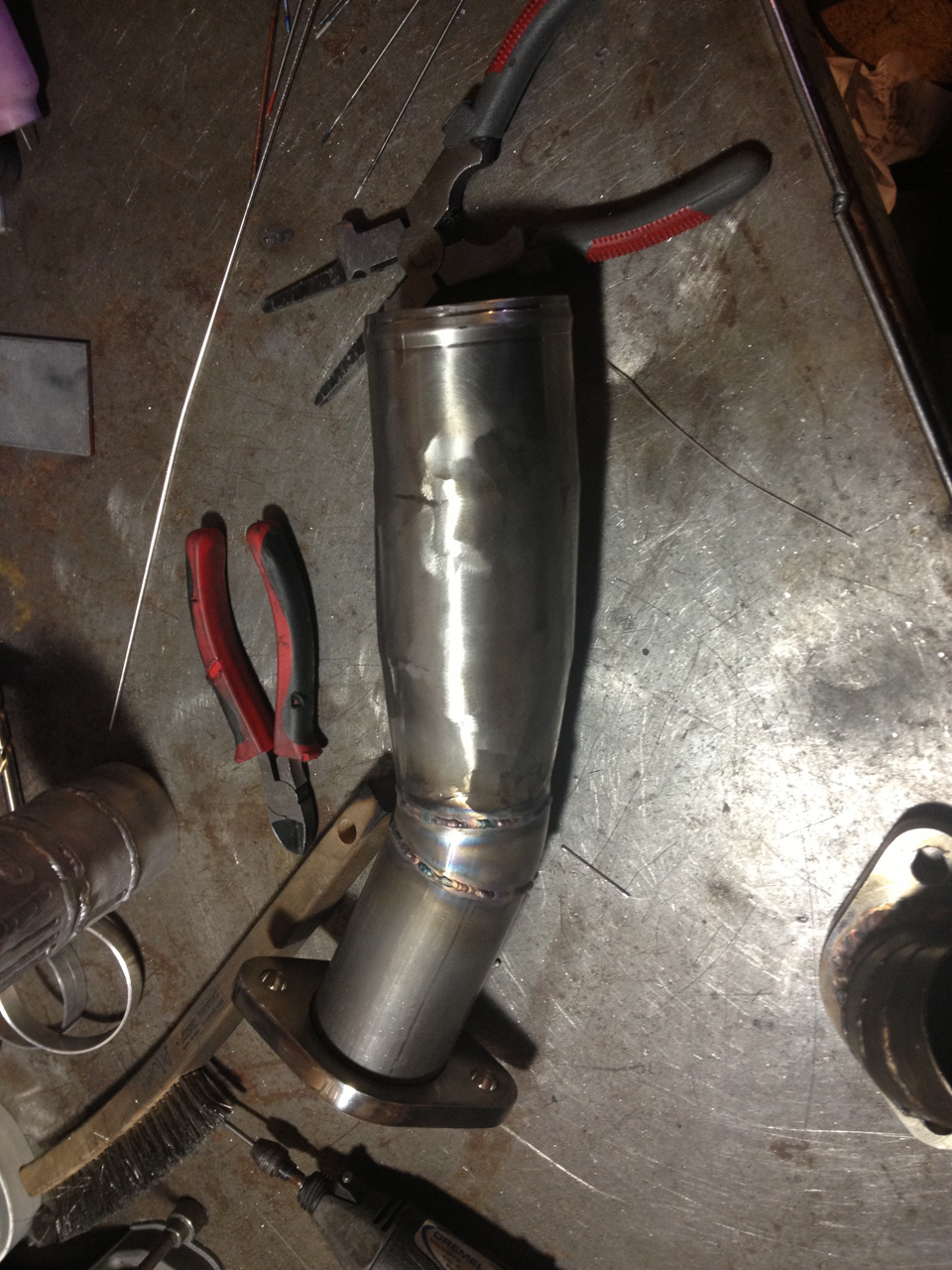

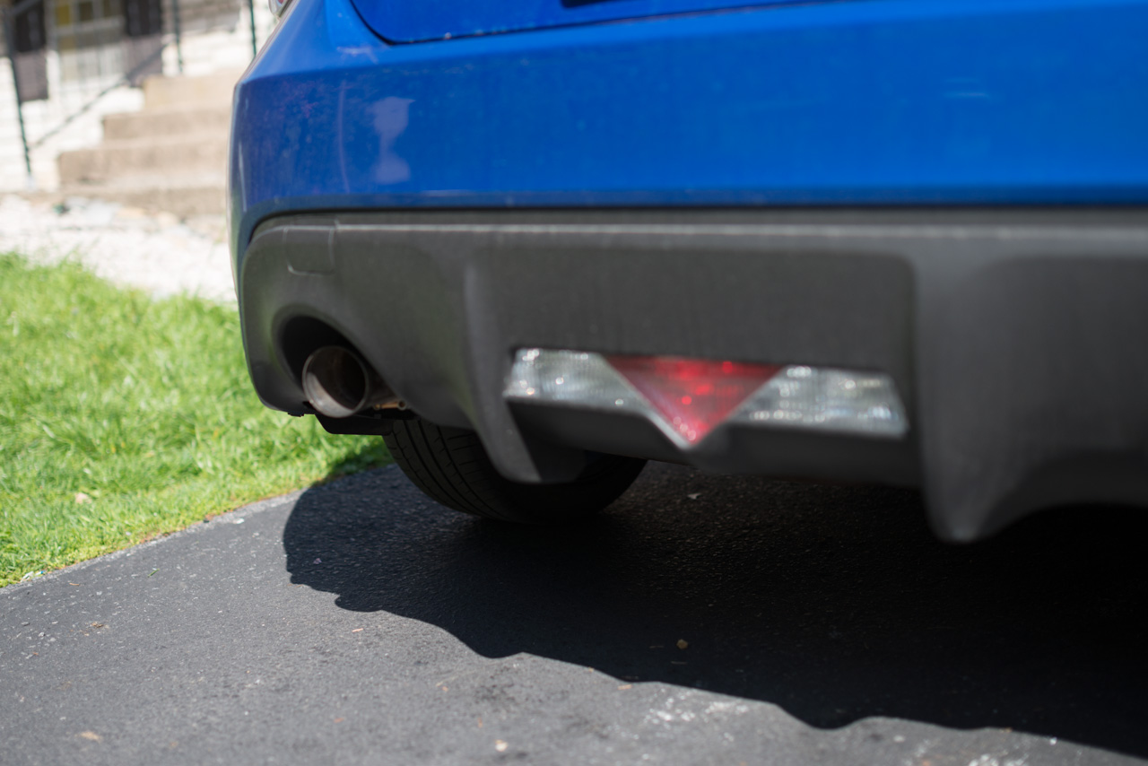

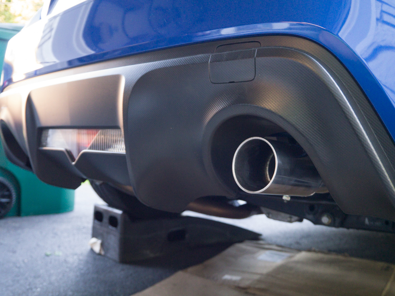

And the cobbled together single. This was actually a prototype IC pipe from the blow through setup I made for the MX-5, but it was enough scrap to put together a single outlet muffler delete. Oddly enough it sounds GREAT. Hardly any drone (only at 2400 and 5000 rpm) so not at cruise, and sounds awesome up top. It gave me motivation to make some plans for production purposes
For now it is back to the stock exhaust, once we get the JDL header we will be doing some pump gas testing and putting together a one-off ultralight exhaust without the titanium price tag, and maybe put together a properly done CAI to see if there are truly any gains there. Until then I think this will remain a NA build, and the goal will be to find the best bang for the buck mods and stay as civilized as possible...at least until the warranty is done

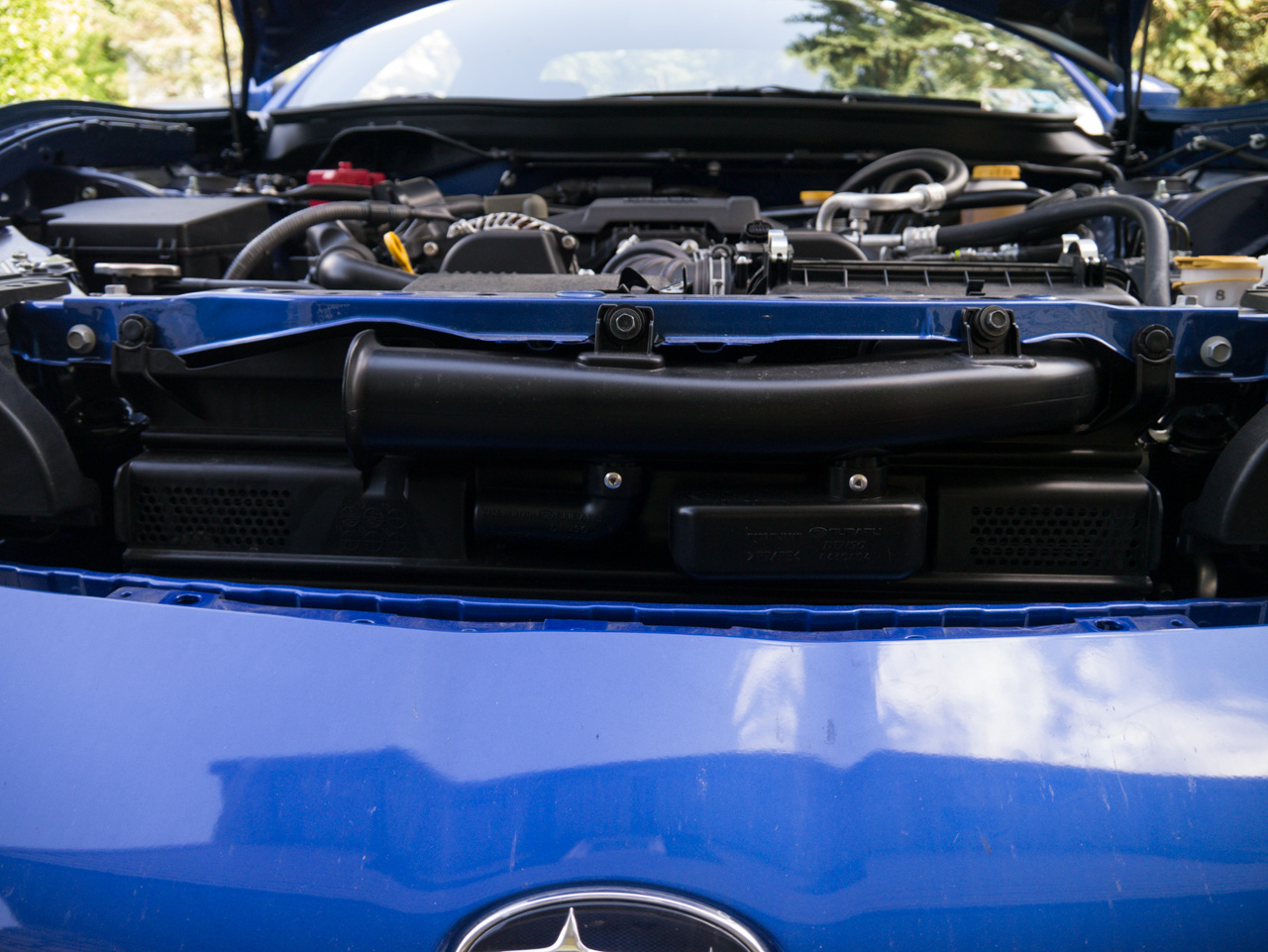

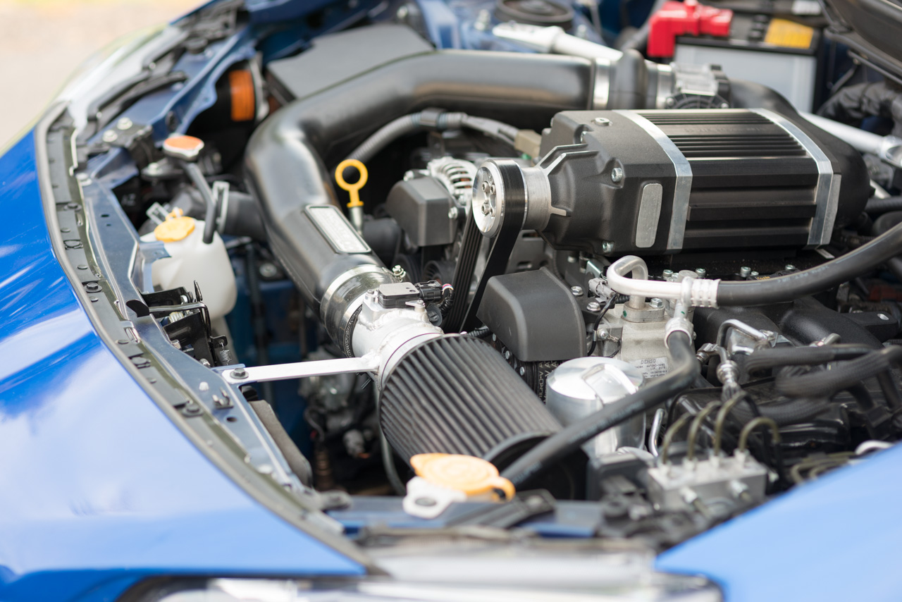

We started off playing with the intake while naturally aspirated. Stock snorkel:
It is a bit small. So for kicks we made a simple aluminum version of a CAI, and it actually worked fairly well and sounded good, but did not yield any noticeable gains. We will hold out until something a bit more, lets say interesting, comes to the market.

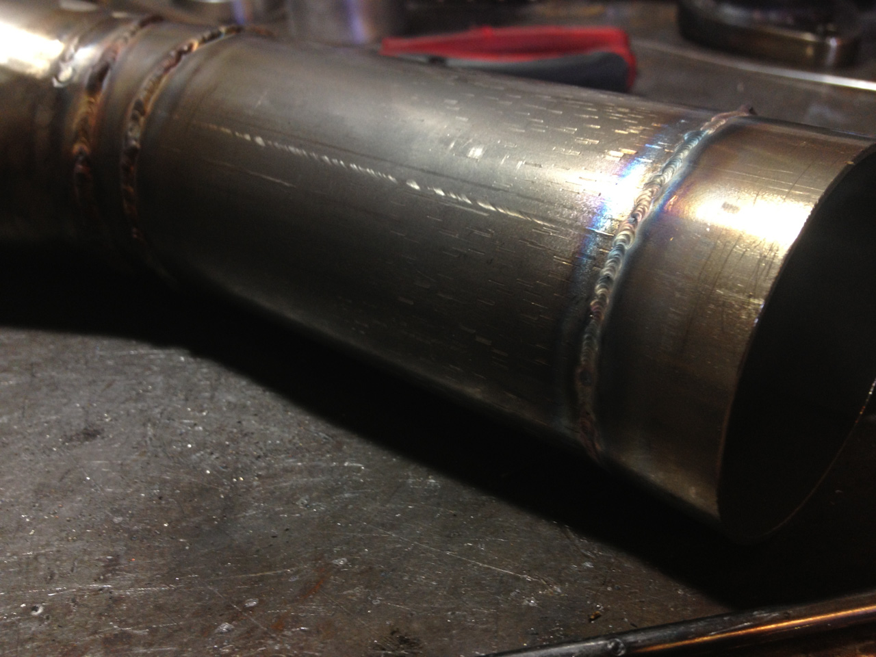

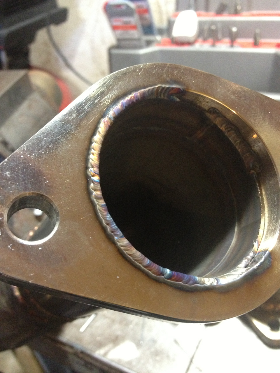

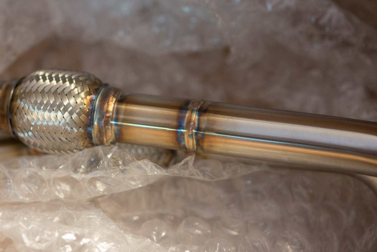

So back to playing with the exhaust. We made an aluminum axle back, as well as cat back. Using custom machined flanges the axle back ended up weighing in at about 4 lbs, and sounds absolutely wicked, without drone! These are likely going to be released later this year, we have 35 flanges here
The exhausts were mocked up and sent our local autox racer for durability testing, who promptly destroyed the one prototype by driving in NYC low enough to be on the bumpstops! So much for the diff clearance...we'll stick to the axleback for now. Why we take our time testing this stuff...

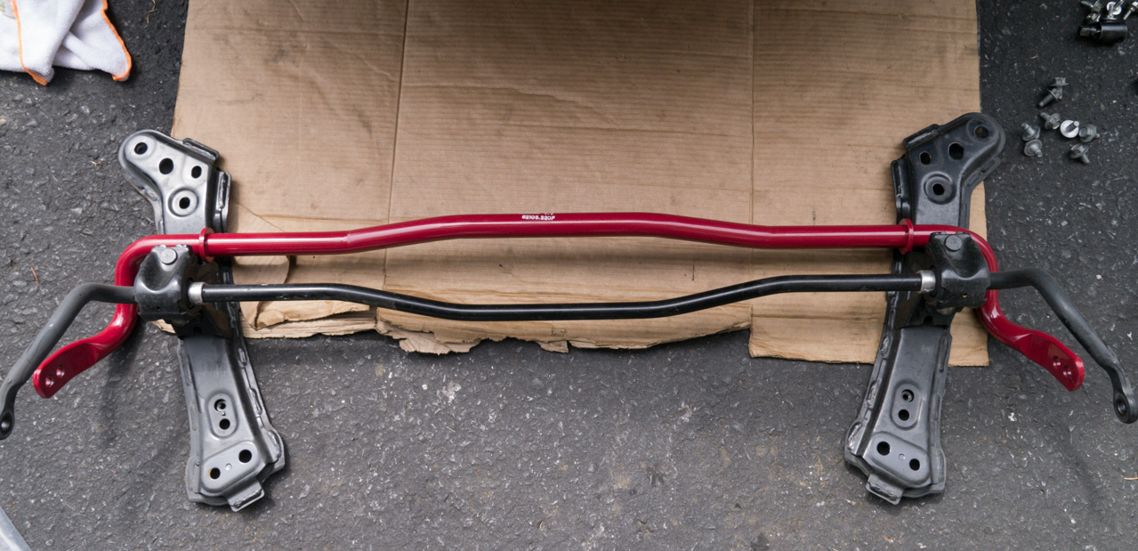

In the pursuit of power the suspension has plenty of room for improvement. A hotchkis rear sway bar and eibach front took place of the stock units.

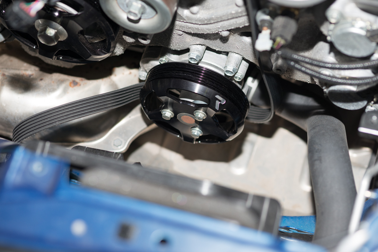

The goal is to have it be a usable street car, so we will see at what point we really need to change out the stock shocks/springs. On the stock tires it feels just fine with the sway bars. Now power...here we had to do something! No amount of tuning can make it feel as we think it should. However, I'm not looking to duplicate the miata (high hp/high maintenance) so we're sticking to a "sedate" innovate twin screw SC.

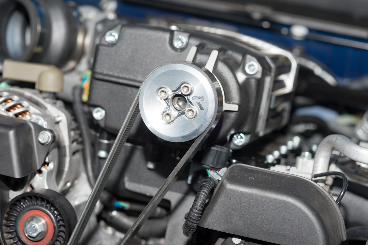

Then we noticed how sluggish the response of this motor is. Adding the SC makes this even worse. Luckily our friends at Raceseng make some kick ass pulleys, so we pulled some off their shelf and threw them on the car.
And while adding the products to the webstore, these just jumped out and we had to grab them!
^^^^^^^ yes that is a go-pro mount built in!

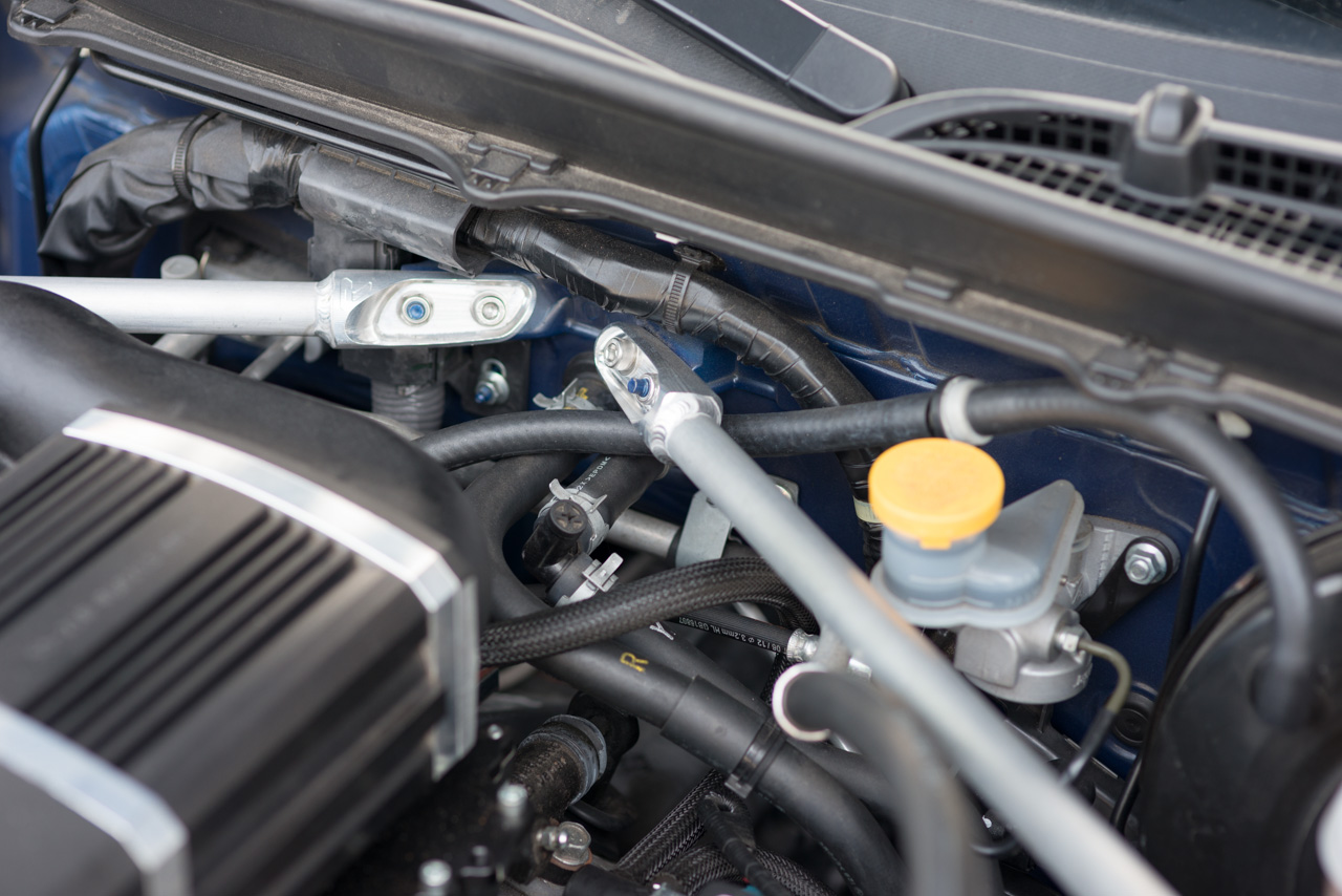

Prototype Raceseng Stiff Arm STBs. Much lighter than stock and stronger.

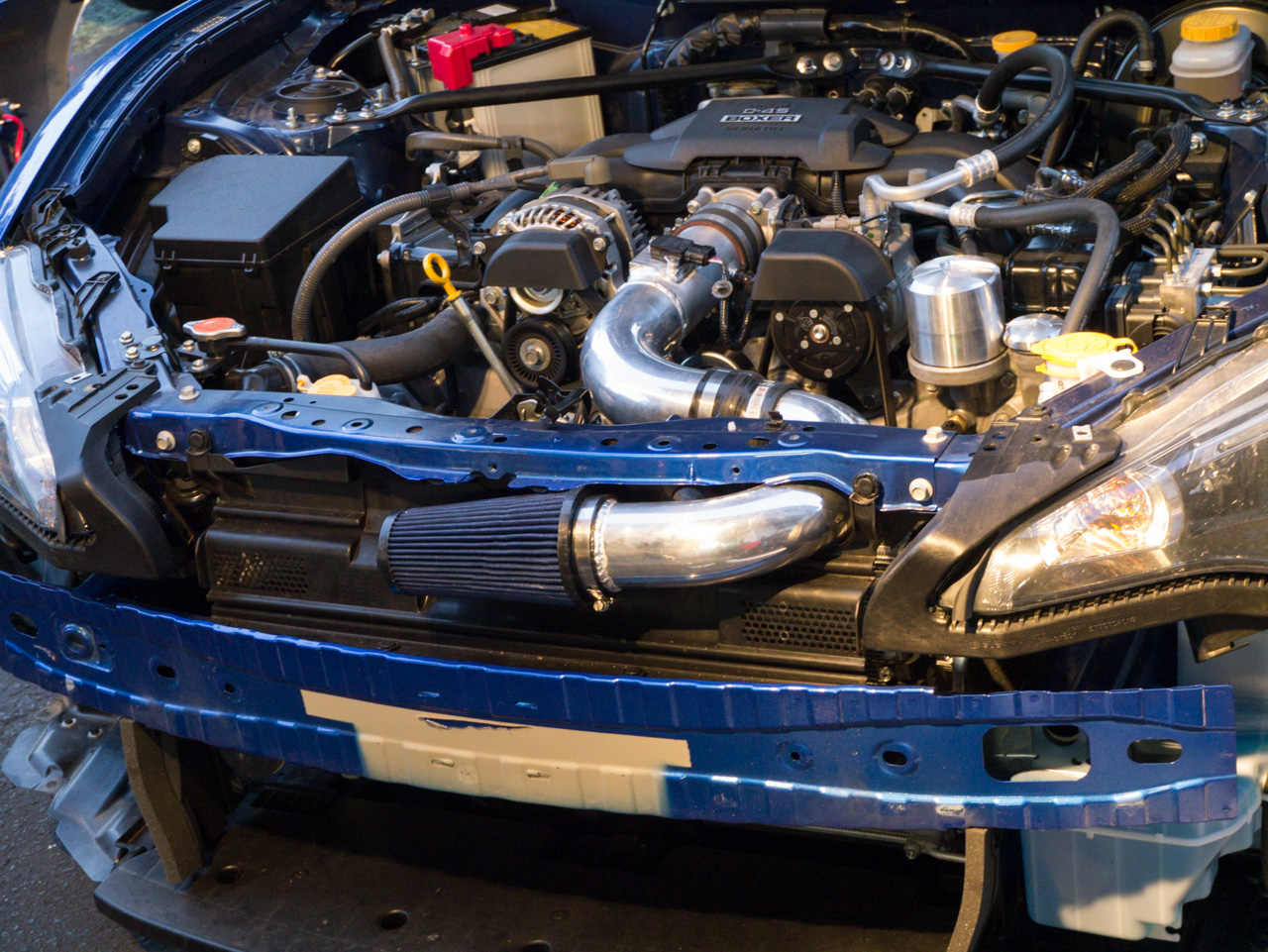

For testing purposes we made a cone filter intake. Sounds awesome!

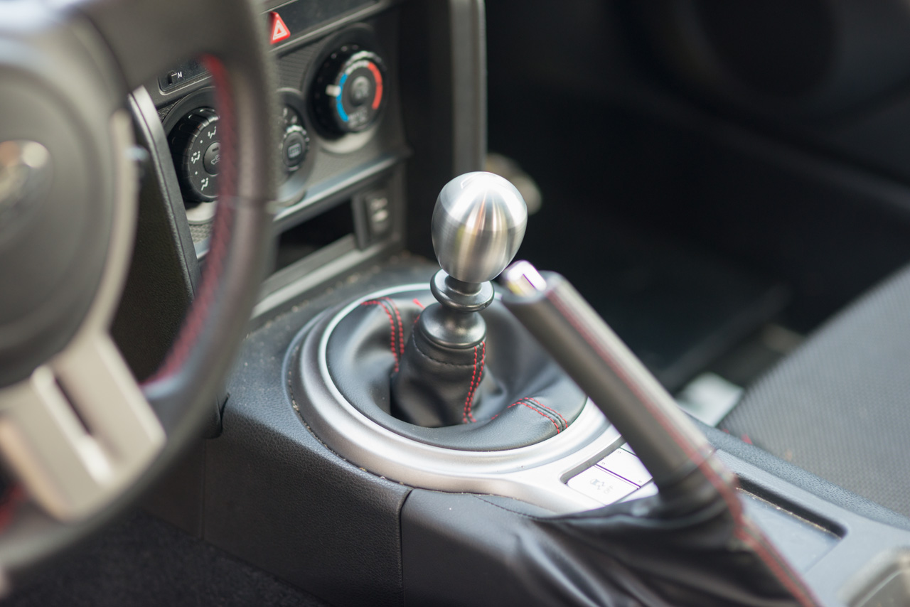

A little interior bling with the Raceseng Slammer shift knob. 623 grams of stainless shifting.

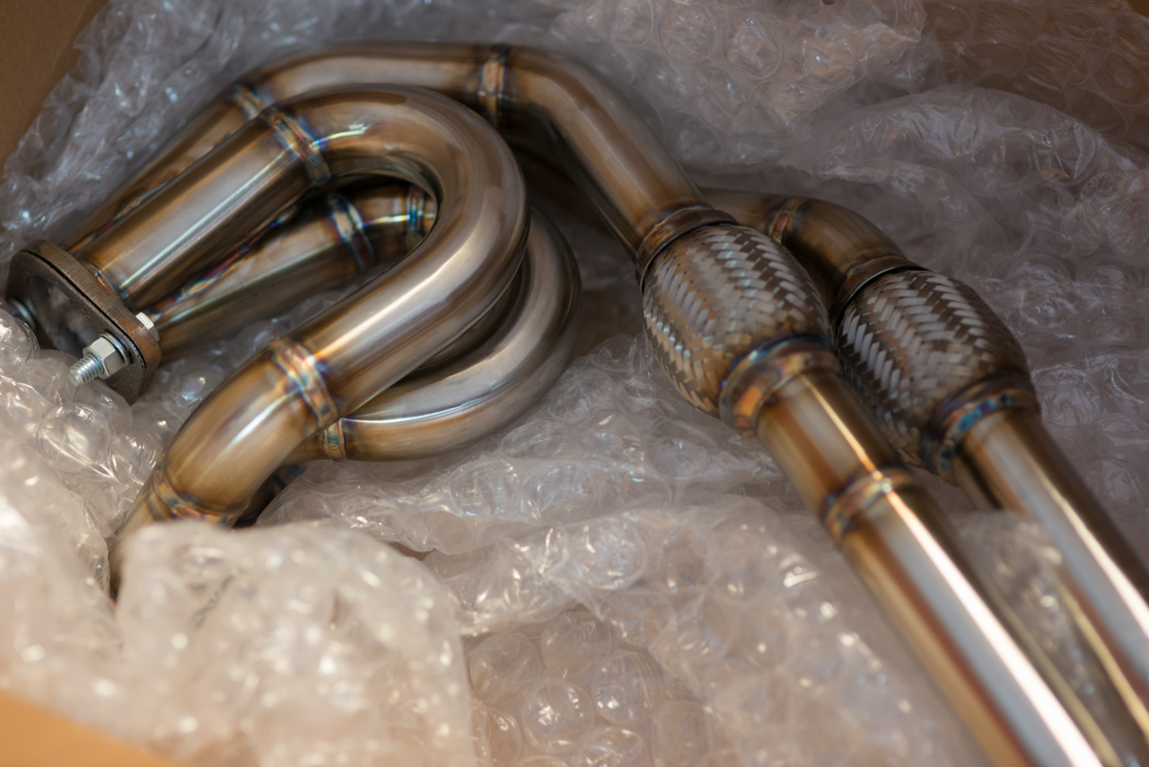

Now all of the power was starting to get a little troublesome on the stock suspension, and the tires were burned through in just 13k miles. We first put on the Enkei RPF1 Tony Angelo edition 18x9.5 35 ET wheels with goodyear Eagle F1 255/18's. Looked a little odd so on went the Muteki lugs in blue and enkei center caps. Fine and good except that it still looked like a 4x4 and the tire rubbed the stock spring perch. It was a good deal of debate, but ultimately we settled on the H&R coilovers. These use stainless bodies, expertly valved, and are a great balance of comfort and performance. Absolutely zero regrets here. They just rock. At fully lowered we were clearly on the bump stops. At the height it is pictured, it handles PERFECTLY. No doubt with a double adjustable shock one could set up for each turn, but this is a street / occasional track or autox car; we will never be devoting the kind of time to make use of that adjustment range. Here it is on a comfortable height:

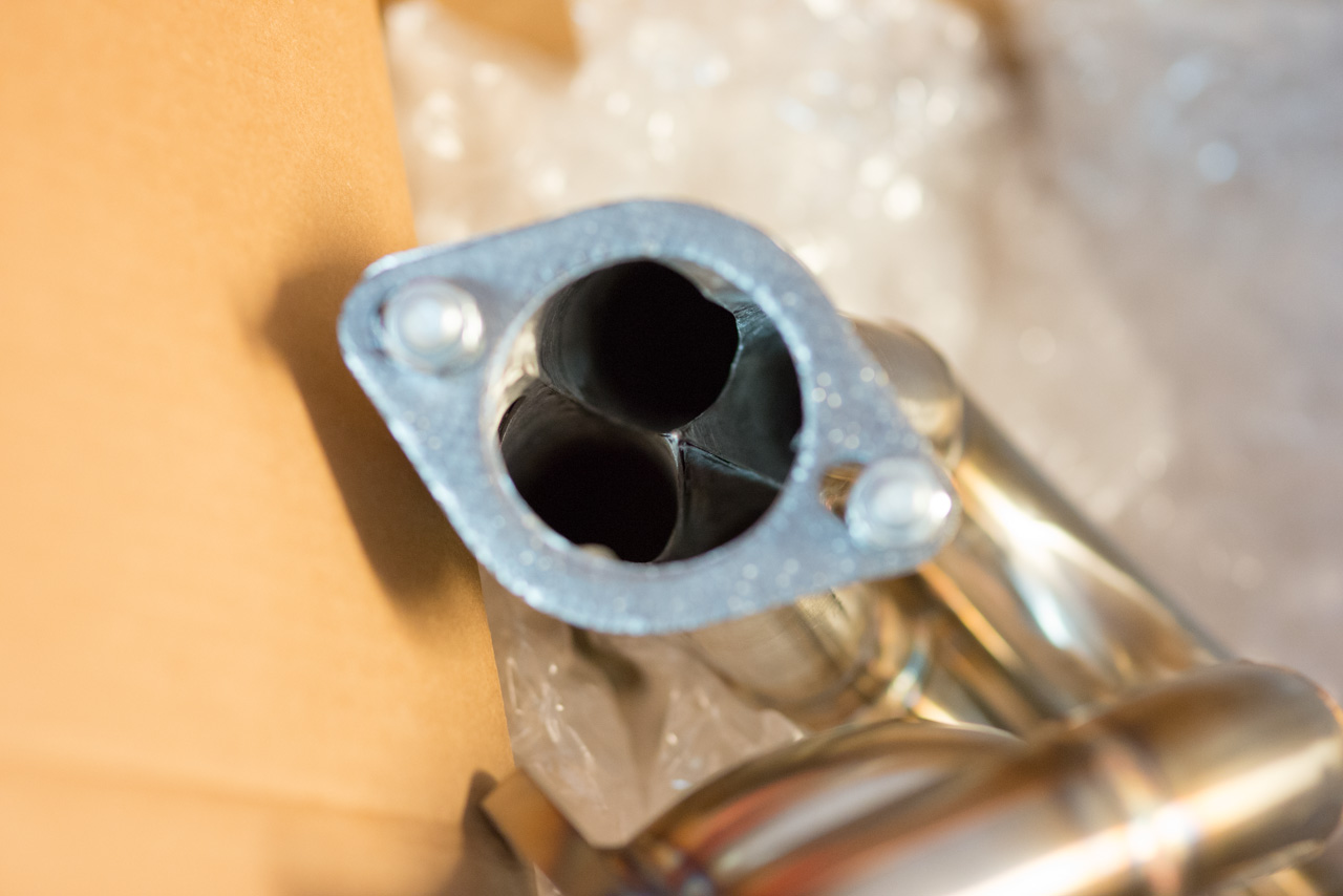

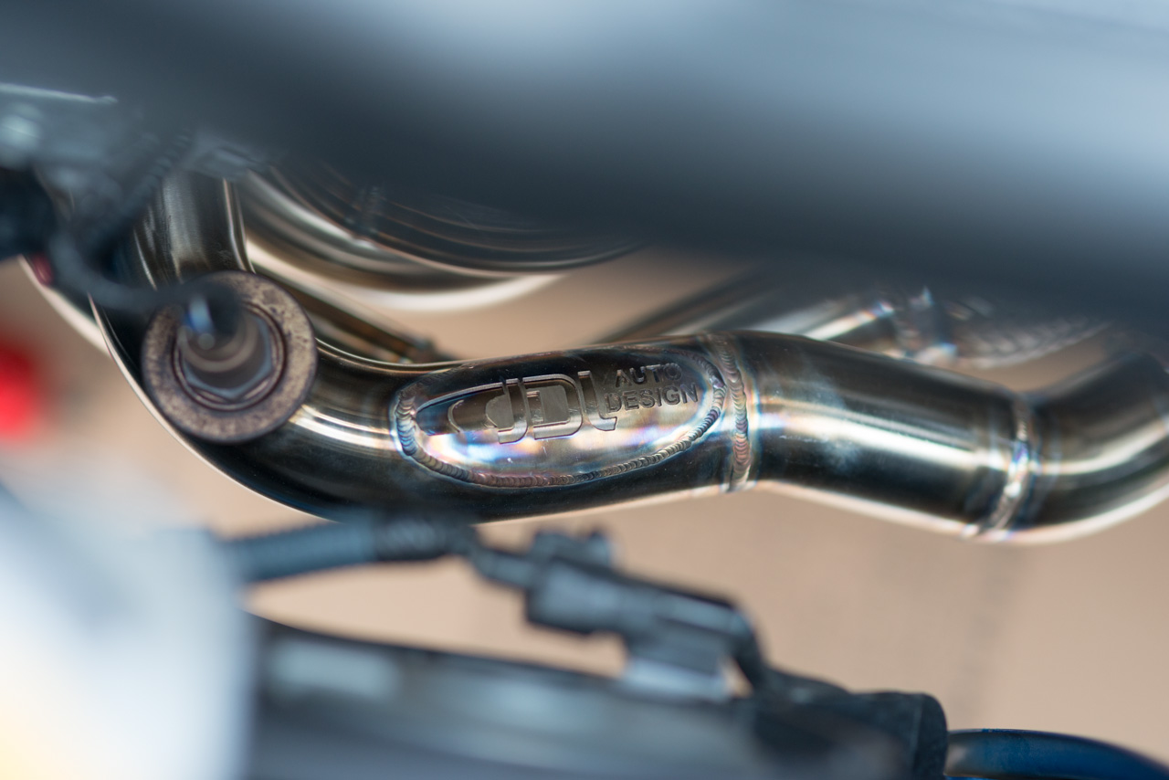

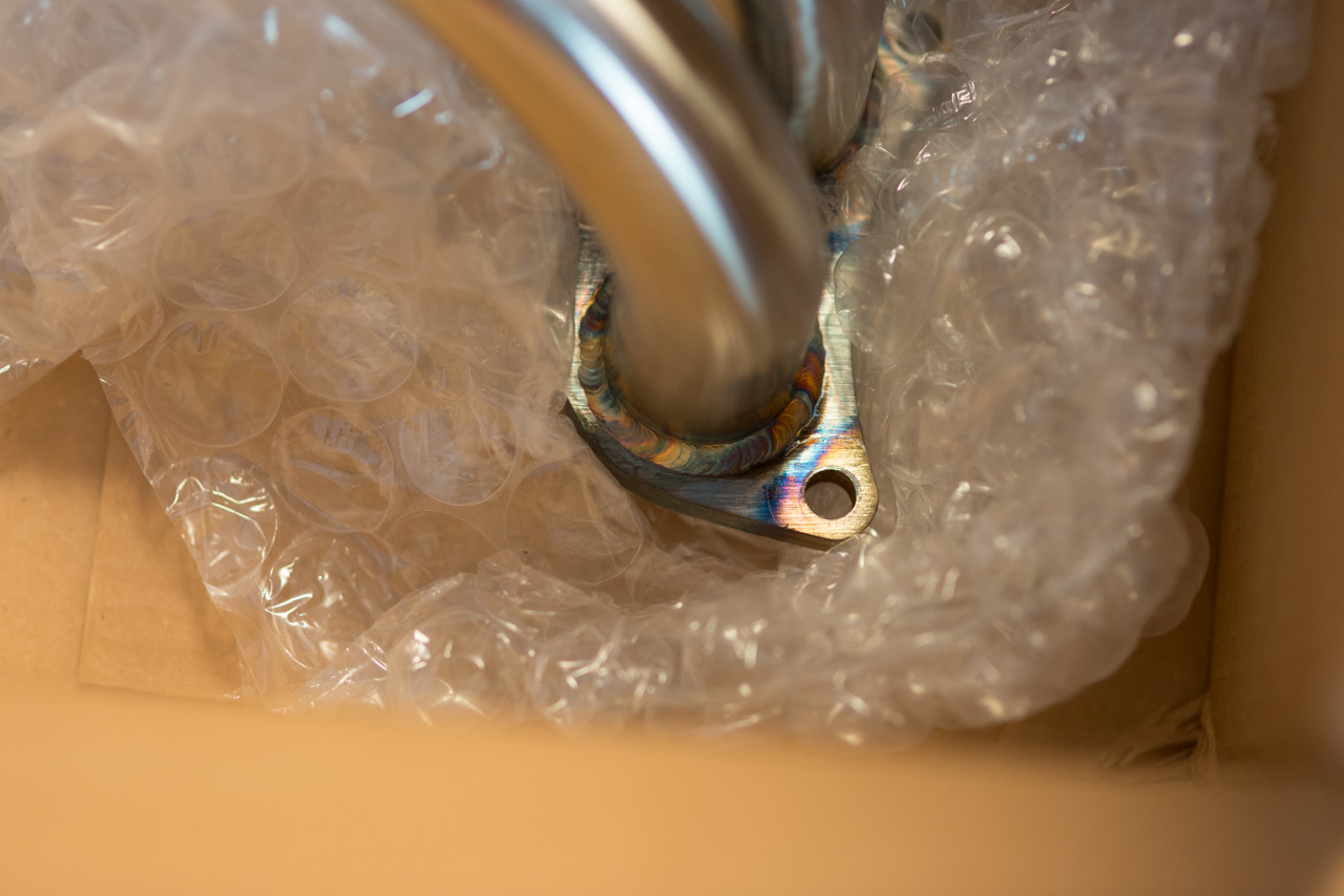

And after months of waiting, our JDL header came in. What can I say...perfect.
