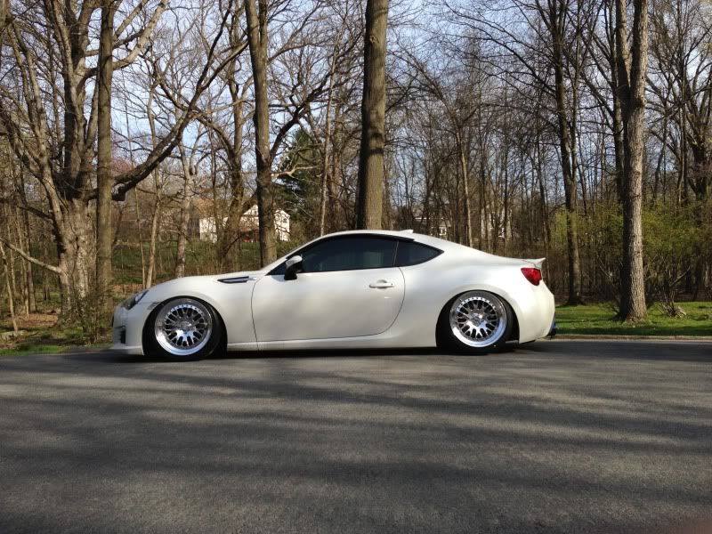

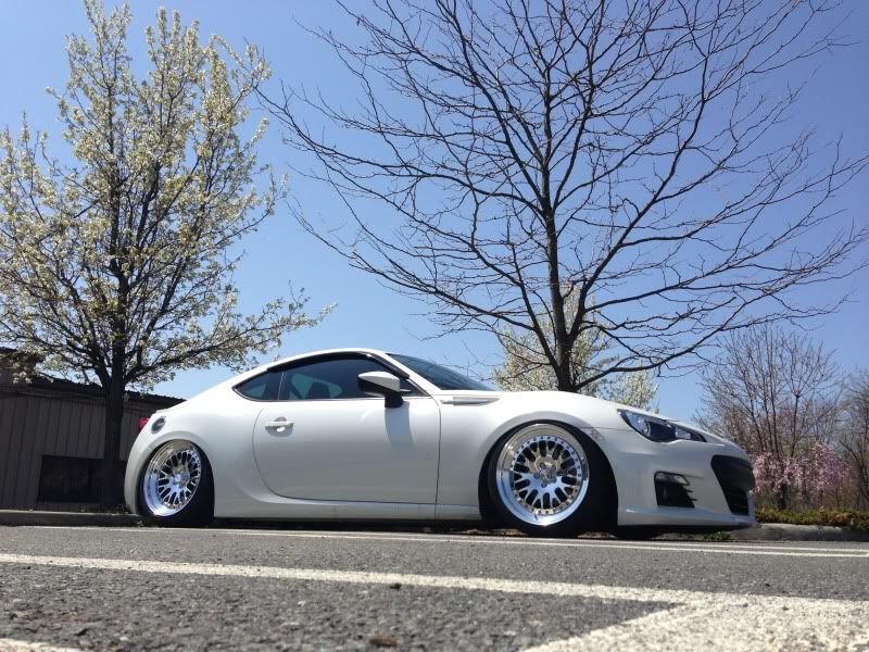

Figured i'd post this in here so it could be added to the directory. I already posted pics in my member journal.
Specs: CCW Classics, Fully Polished, Bridgestone RE760 Sport
Fronts - 18x9.5 +33 (38), 245/35/18
Rears - 18x10 +38, 255/35/18
Weight: Wheels are 20lbs. came out to 47.2 with tires for the rear. Believe the fronts were 45.x. Stock wheels with Blizzak LM70 were 40.2lbs. So overall about 20 pounds added...not bad considering the sizes and these wheels are the street version which are heavier.
I had to use a 5mm spacer to clear the airbag, this wasn't on purpose I think I just didn't communicate properly to CCW as they asked me about this with inboard clearance when I talked to them on the phone.
This is aired out completely - My driving height measured out to -2.5 camber all around. It would have been 1.8-2.0 in the front (like I wanted it to be) if I didn't have to end up putting that spacer in. I'll try to snap a pic of the driving height.

HOT!
CCW's look great on everything

Love CCW'S, but too low for my taste.

i'm on bags, I drive higher
