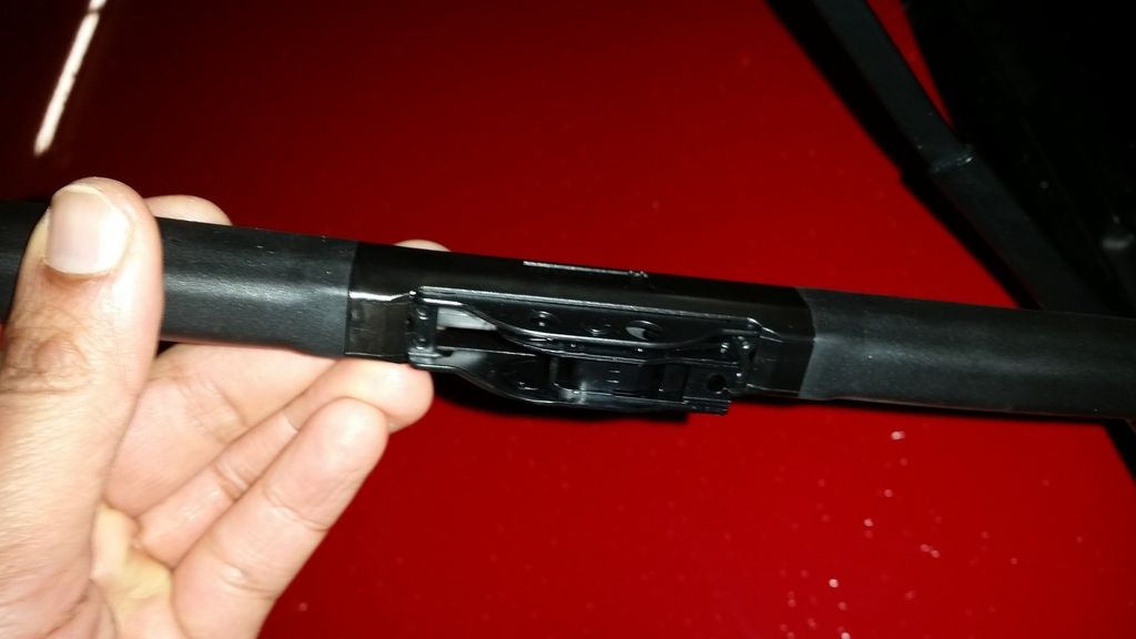

Changing Wipers: Stock to Aftermarket

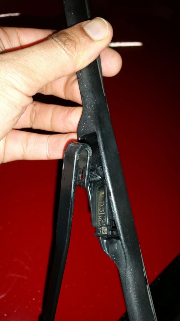

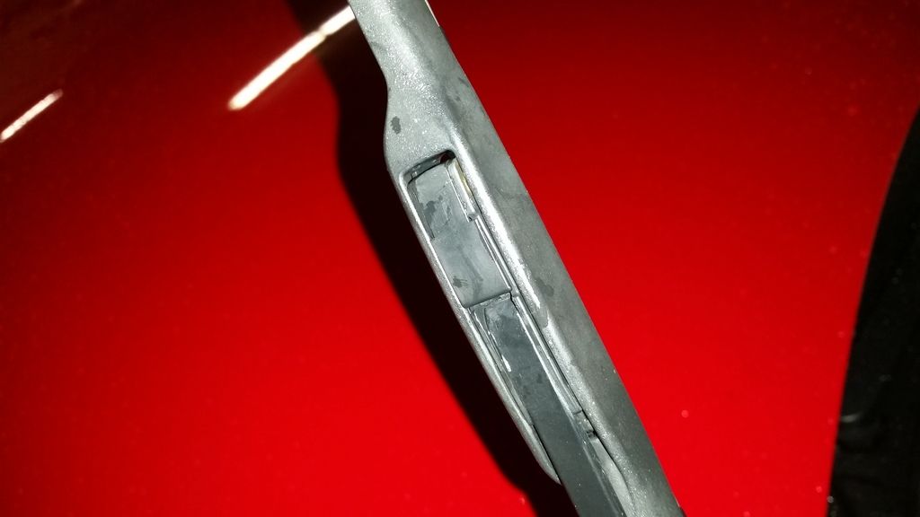

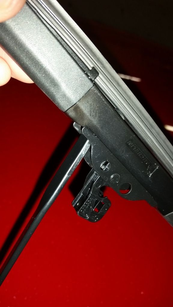

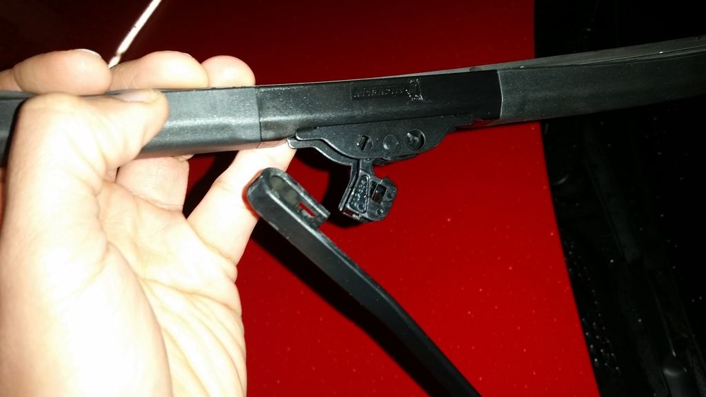

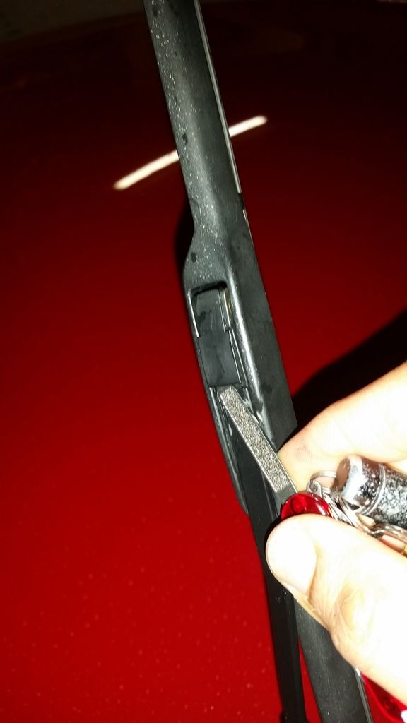

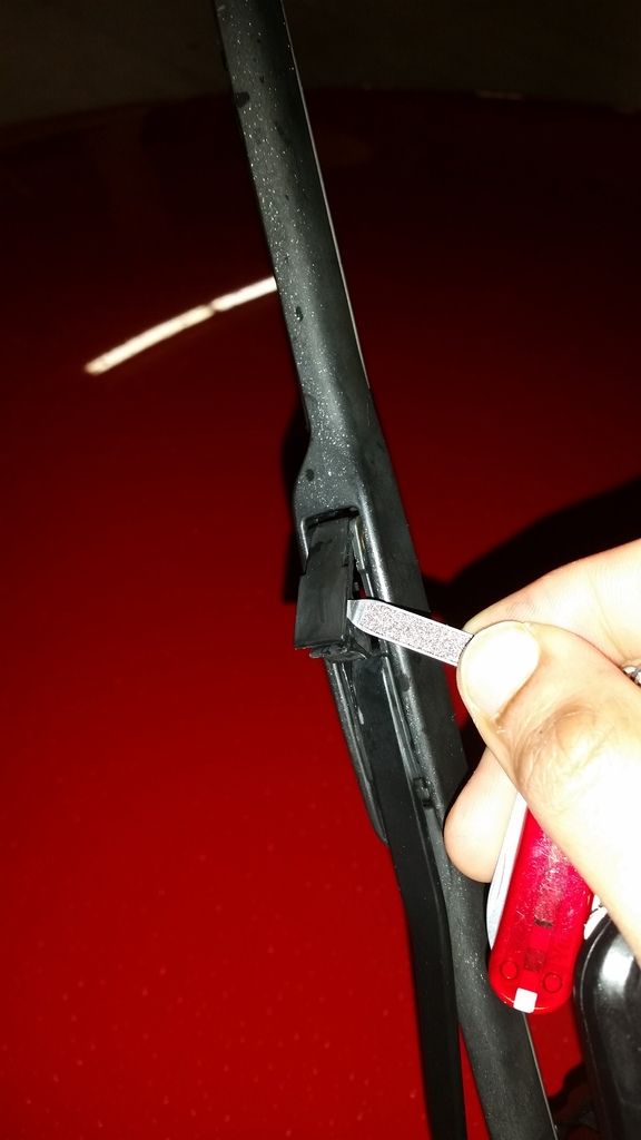

To change your stock wiper blades to aftermarket ones:
Pull up your stock wiper (obviously)
With a lever, or even with your long fingernail, pop up the hood-type clip at the joint where the wiper arm & the wiper blade meet
Pull the wiper blade down
Although aftermarket wiper blades usually come with several adaptors, you usually don't need one for your FRS/BRZ/86.
Just slide it up till you hear a click sound
