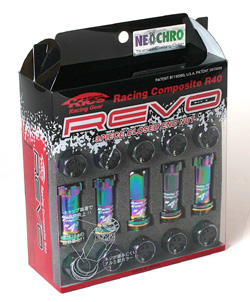

Best lug nut?
Hi FT86ers
Money aside, what would be the best lug nuts?
Meaning it will be strong, reasonably light, secure and will not fade or chip when removing wheels a few times a year. I will be using these for the summer with my TE37SLs.
I have personal experience with muteki SR48 and Ray's Dura Nuts and I will not be going back to those as the muteki chipped after 1 track season and the RAYS basically faded to nothing.
A few choices I have on my mind are:
Any recommendations or pointers?
Thanks!

There are lots of great choices out there.
The ones you listed are more on the high dollar tier nonetheless great lug nuts.
There are pros and cons of lug nuts.
We typically use the Muteki SR48's - affordable, available in various colors, and extremely durable.
They are made out of 50BV30 steel, which is heavier then aluminum but can take a beating for years to come, and threads will hold up.
Kics R40 is another great choice for lug nuts, which is also steel construction.

I have the Project Kics Leggdura racing lug nuts and they're excellent.
