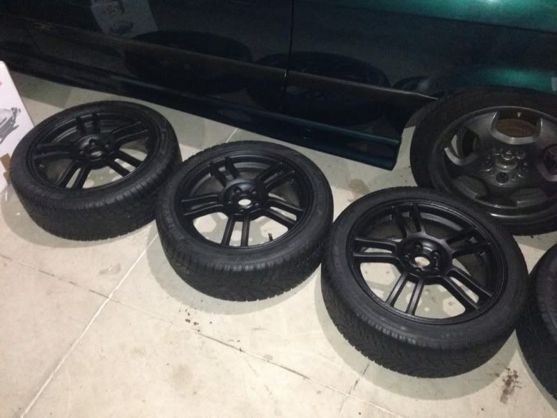

Found some Mille Miglia wheels on Craigslist.
17x7.5 5x100
205/50/17 Dunlop Wintersport 3D tires
5 coats of plasti dip later:
Should have them on the car tomorrow.

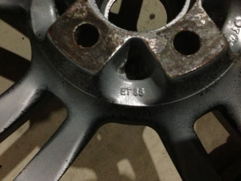

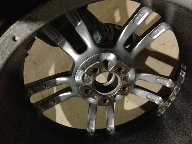

So this sucks... Been tryin to figure out what I'm going to do for a week or so now.
One of the wheels is a +35 offset and the other 3 look to be altered (machined down) to a 52 offset... Didn't notice it until it was too late. Anyone ever heard of wheels beeing machined down by this much? Any thoughts on what to do to make this set work?
Pictures:
Machined down (hubcentric ring installed)
Untouched stock offset (missing hubcentric ring)

Looks like an awful lot of material removed, especially for a cast wheel. No real way of knowing if there are cracks or other issues.
