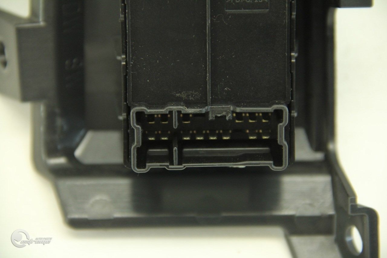

I'm trying to retrofit a USDM passenger door lock/window switch to my 2013 86 because mine doesn't have the door lock/unlock button. I already have the USDM switch panel and it's plug and play with my harness. I've studied the wiring diagram and I only need to hook up pins 15 and 16 on my passenger switch connector to the wires on the same pins on the driver side. I need the female terminals that will slide into the empty terminals on my passenger switch socket. Anyone know the part number or an aftermarket source for those pins?

Bump. Also looking for this info regarding the female wire terminals for power window switch
Even a trade name or specification insights would be helpful
It doesn't seem to be a standard Toyota or Subaru connector, so it doesn't show up on connector diagrams. However, it's a somewhat common connector and used on window switches for other Subarus and Japanese auto makes

This looks a lot like it but I'm having difficulty getting a real part number for the connector.
https://www.amazon.com/Assembly-Conn...dp/B08BJ3WX2D/

It's a Furukawa Caselanceless Standard・NS-LC type, NS16FW-LC, PK415-16017.
